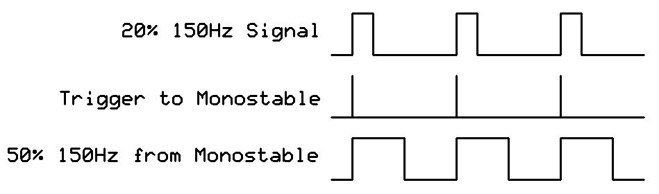

Ok I start to understand. The problem is that I have to make a long transition and I can't have 50% duty cycle in the emitter (too much current).The best I can give for this is 20% or less. I use 4% or 5% duty cycle for the other ireds. I will transmit 300Hz and then I will use a divider but I don't know any circuit: divide by 2 bistable. So if you know any circuit or an IC that does this work I will be glad. Thank you

How precise and accurate does the 50% duty cycle have be? I don't recall you saying. If the frequency is unchanging, how about a monostable with a period of 1/2 the period of your transmit frequency, triggered by the leading edge of your 20% pulse. 3.33333mS for your 150Hz frequency signal.
Or, is there something else I'm missing.
Ken
Ken
