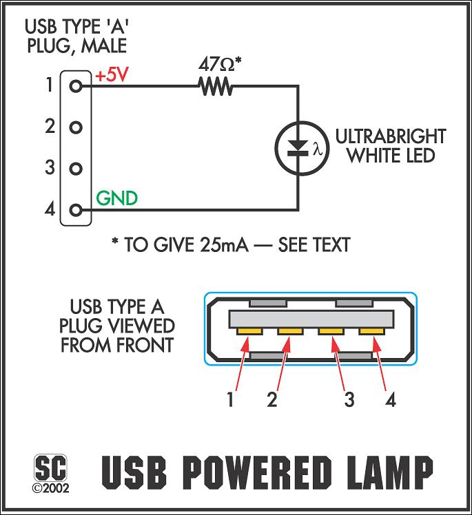

i'm using just the power from the usb port like this, in the image..
So, i'l be connecting a resistor in series like the diagram so that it gives lesser current.
I need to clear 1 doubt tho, how much current should i actualy use so that the circuit will work fine?
That way, i'l just attach the appropriate resistor..
Also, so at least, the usb port idea for power supply is fine right? I'l not use the transformer then..

You mentioned connecting a resistor in line with the supply; what, to the micro? You may find that it doesn't work very well. I would think that the LEDs should have limiting resistors, but not the micro.
47 ohm resistor to put 25ma into an LED? What LED has a 4.4 volt forward drop at 25ma? Most white LED's are around 3.1 volts at 20ma. For 25ma into a normal white LED would be closer to 75ohms.
The datasheet for your LED lists its max allowed current (maybe 30mA) and its range of voltages.
You must calculate the value of the resistor to match the spec's of your LED.
Most white LEDs are around 3.5V. But LEDs have a range of voltages so your white LED might actually be only 3.2V. Then for 25mA the resistor value is (5V - 3.2V)/25mA= 72 ohms. Nobody makes a 72 ohms resistor so use 75 ohms.
If your LED is actually 3.6V then the resistor should be 56 ohms.
Damn audioguru, are you following me? =) I think that's the 2nd time in the last few days I posted at the same time as someone else with the same answer.
LED math is one of the few things I'm good at =)
I would like to know where the original poster got that image from though, it says that resistor is for 25ma, even though the LED will probably draw 40ma with it. That's not a small error.

But, i'v just added the diag to show what kind of supply i'm going to use..
Just think that,ther's my whole circuit in place of the led.
The port should give 5V and a suitable current value to power the microcont Vcc as well as all those places where 5V is reqd.
I'm not worried about the leds, coz i'm adding current limiting resistors to all. Its about the microcontroller.. It should not remain off or something if the current's low (dont know what'l be the consequences) or shouldn't even get damaged, if the current's high..
Again, Thank you all for all this help.. Really appreciating it all..
Can't just think that Tan... The diag you showed is wrong.. so we have to assume your circuit is wrong as well. For an IC you wouldn't use a resistor at all....
I'd go for 68Ω because it's an E6 value and much easier to come by than 75Ω. If the LED is 3.2V then the current will be 26.5mA which is probably all right at the maximum rating will be 30mA.
