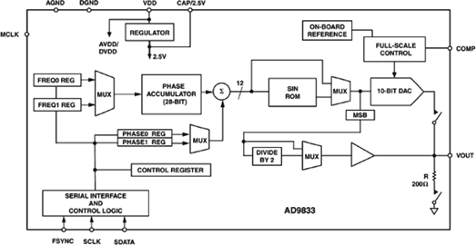

Have you considered using one of the Analog Device DDS chips, programing them is very easy. I been using the AD9833 device. They take very little space and programming is just over simple SPI interface. I assume your receiver has a microcontroller onboard. Well just a thought.
ad9833-fbl.ashx
https://www.analog.com/media/en/technical-documentation/data-sheets/AD9833.pdf
You can get a premade module from ebay that would just plug into what ever pcb you have for cheap.
The module has on onboard programmable PGA with a digital pot for setting gain of the output.
Here is how I interfaced the Module with a microcontroller, just 4 wires.
