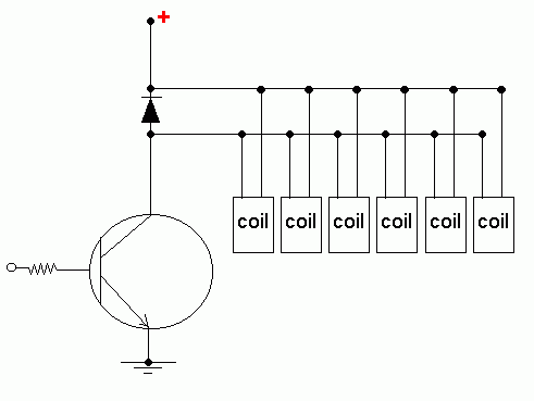

here.
It's an injector driver.
I've added enough base current to give 6 amps when there is no load(load replaced with multimeter).
With load connected it only gets 3.8 amps.
With transistor bypassed the loads passes 4.12 Amps.
Transistor used is 2n3055 (to3)
when I use an mj15003 (t03) it seem to energize quiker.
Car idles richer for the same pulse width.

You didn't show enough of the circuit :lol:
We need to see the driver arrangements, it still sounds very much like you need to increase the base drive substantially. A 2N3055 if a very low gain device, to staurate it you really need to hammer some current into it's base!.
When you replace the load with the multimeter, the transistor has about 12 volts Vce. Its beta will be much higher than it is when it's saturated (with maybe 300-400mv Vce). You need to hammer the base with at least 400ma to get good saturation at Ic=4 amps. You can buy logic level MOSFETs to do this, but be aware that you still need high drive current capability if you want to switch fast, because the effective gate capacitance is very high.

I put 1 Amp into the base, but still have the same problem.
I'll put more tommorow.
I even used two power supplies, 1 for the controller and 1 for the injector driver.

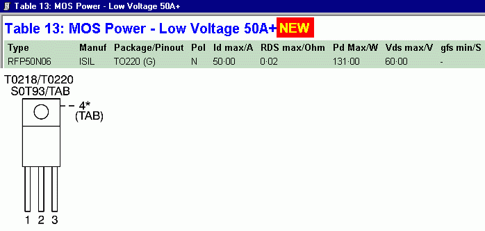

Like I said, I would use a Mos-Fet. Probably an RFP50N06. Thats a 50 Volt, 60 Amp Fet.
You would only Need ONE, Mounted on a suitable Heatsink. And Since I would Think you have close to 12 volts drive to the gate, (You haven't shown the drive circuit) But Almost no current is required. Definately in the Micro-Amps.
This Device has an ON Resistance of .028 Ohms, Resulting in Negatable Loss.

Hi Gary, I sourced the fet.
Do you know wich pin is the gate etc?
I know nothing about these devices.
Can A multimeter work that out?
Thanks :)

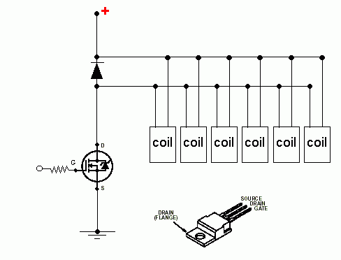

Is this how to use it?My pic is probably wrong. :?:
is the gate the same as a base on a tranny?.
is the Drain the same as a collector on a tranny?.
is the Source the same as the emitter on a tranny?.
Yes to all three..

The picture is wrong.
I bought that fet, and tested it as a transistor.
It didn't work as one!
After thinking it was faulty, I thought it may be digital, as it only has an on and off.
I wired it up digitally and, Yep, It now works properly. Its neads to be triggered as a digital component.
Are all fets to be wired as digital?
and bi-polar trannies as analog?
It wouldn't, it's not a transistor, it's an FET - try testing it as an FET!.
It needs to be connected and driven correctly, nothing else!.
No, either can do both equally well, but you can't just interchange them - the circuit configuration required is different, as is their method of operation. As already mentioned, a transistor is current driven, and an FET voltage driven.

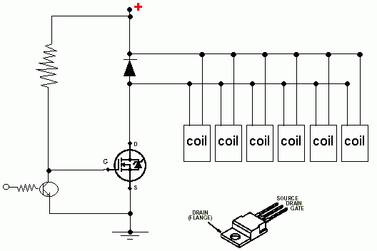

As I sad before, I don't know how they work.
The pics that I found on the net don't work.
So I tryed the following and it works.
