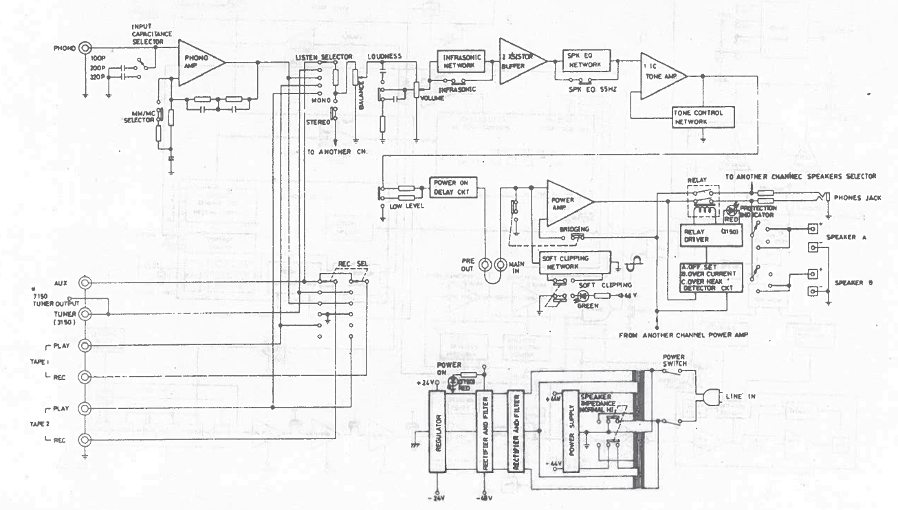

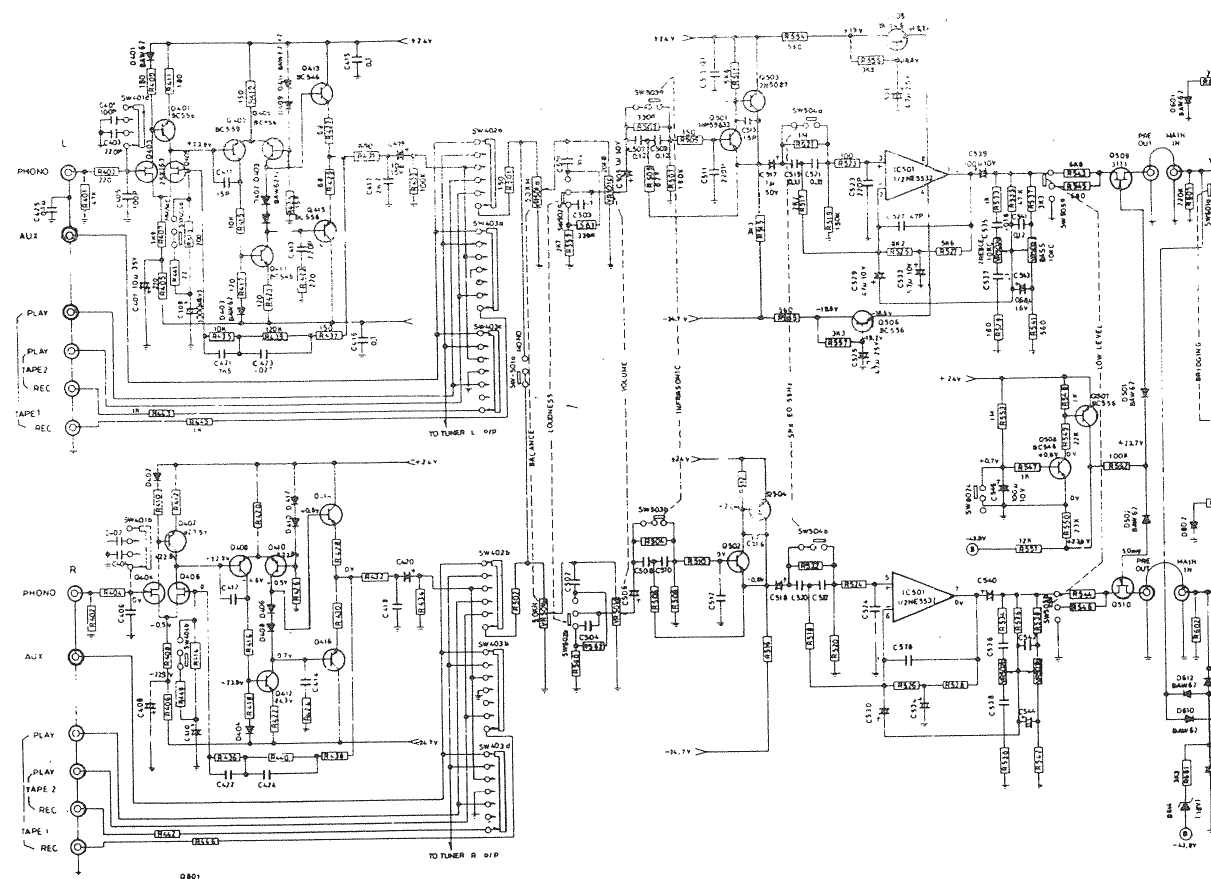

I see there is a mute circuit on the output of the preamp, triggered by a switch? - that would be a prime suspect, as it's a mechanical part common to both channels of the preamp. There are two small diodes, D501 and D502, their cathodes join together, measure the voltage at that point, with it working, and with it not working - does it change?.
Good catch, correct, BOTH channels are going out at the same time when this happens. I've been going through the diagram to see what components might affect both channels. There's pre-amp controls that affect both channels, I did try pushing every button, and turning the volume/balance knob to see if i got anything, but it's just dead when it's upright. I'm guessing you're thinking it's power related? since it likely goes to both channels. Attached is the block diagram and the circuit diagram (appears to be handwritten, and the scan is pretty low quality, also linked in my first post)

As I said before, check the voltage on the cathodes of D501/2. And I never suggested a power problem, although that would be one option, but the mute circuit looks more likely.

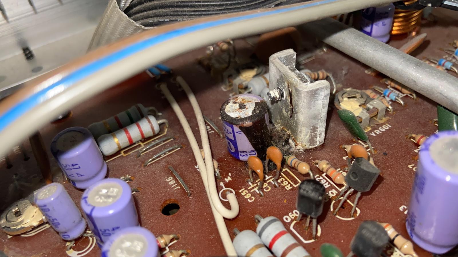

I did notice that one of the capacitors was leaking, but Iooked at the repair manual for this and found that the leaking capacitor is a part of the power amp side, which is still working.
Is the leakage wet? Or is it dry, hard and at the base of a largish component? If the latter, it is more likely to be glue the manufacturer used to help hold the bulky part in place and reduce stress on its leads. An actual physically leaking e-cap is fairly rare.
This is what the cap looks like
I did peel a bit of the black crusty stuff off the top when I was trying to get the specs on the cap
I'd agree that is leakage. Just seems that many mistake the glue for leakage. Yours is not glue :).
