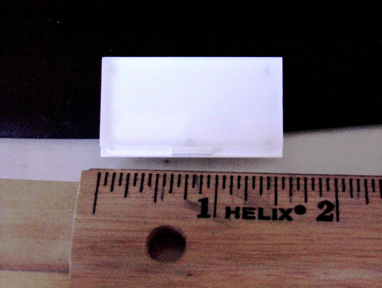

I acquired some parts that a college was giving away for free. They included: LED Arrays, 7 segment LEDs of various sizes, and this...
It's rather small and the front has a frosted plastic covering. There are two leads coming out the back. Any ideas as to what it is or who made it? Any help is greatly appreciated.
Nuer Tek
Front:
Back:
A rectangular cotton ball?
OK, I'm done being a smartass now. :) I honestly don't recognize it but I'd guess a capacitor or antenna or some kind. Have you tested the leads with a digital multimeter? Does it have any markings at all, maybe along the sides?

Possibly. Try powering the leads with 2.4v with a resistor on it. Flip leads on it until it lights up. Since the other stuff was LED items, it would make sense that this was a backlight, also the 2 leads.

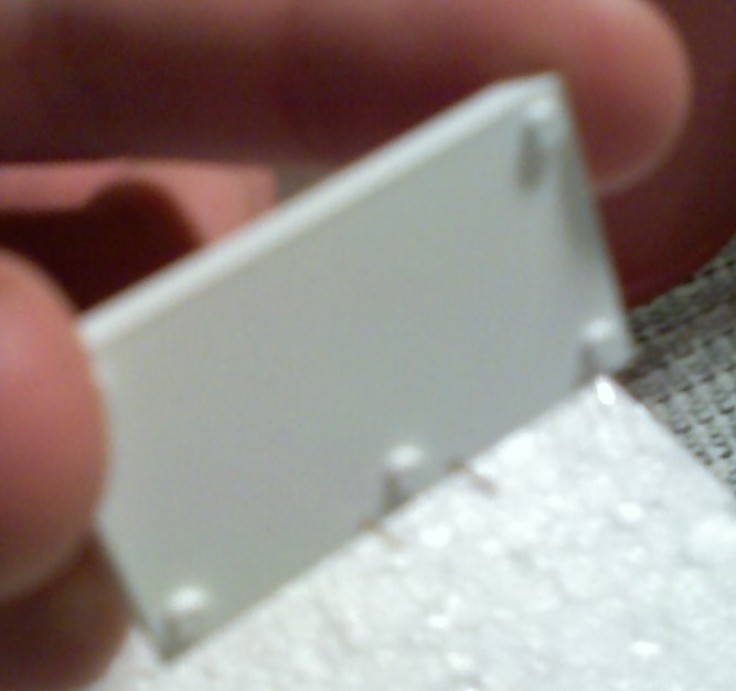

Sorry about the photos...used my phone b/c it was the only thing on hand. What size resistor should I use when testing? No markings are on the item itself. The packaging has part of it cut off (probably where the part number is). Once I know what size resistor to use, I'll test it out!
Actually it does look like it could be perhaps an electroluminescent backlight. If it is you may need an AC supply to power it.

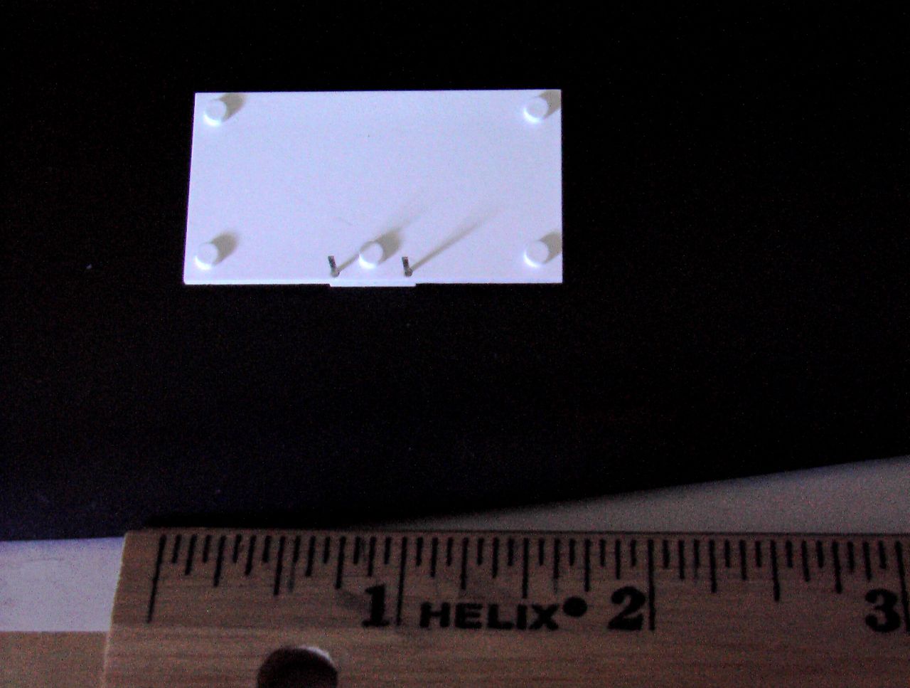

Here are some better pictures:

In some occasion the diode check MAY lite an LED. make sure you're in the dark and check it with Diode mode. MAYBE it will lite up a little bit. Unless.. it might be one of those EL backlight type... and it need ~100Vac :eek:

I had "almost the same looking" device some year ago .. it was the backlight for the lcd... I powered it with 5V DC over 500 ohm resistor.
the backlight i had looked exactly the same in front and bit different on the back (6 thingy's and not 5, and the leads were on the side, so parallel to the plate, not normal to the plate as your leads are)
