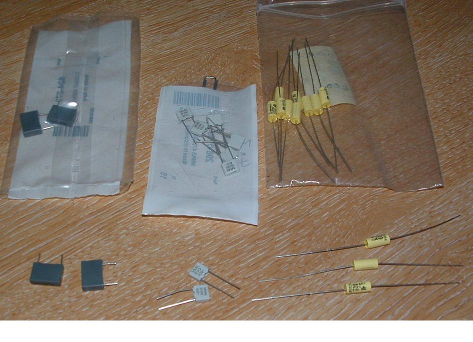

Does anybody know, is there anything special about a Mylar non polarised capacitor ?
I've got a schematic that specifies 'mylar' so I looked on Google which suggests mylar is polyester film; Rapid shows them like small disc caps; RS shows them like ceramic blocks. I'm confused !!
Anybody know ?
S
Have a look at the picture:
These are Polyester capacitors, a plastic film like mylar.

The round cylindrical "mylar" capacitors were made about 50 years ago. The rectangular block polyester ones are the new kind. Get them with a tolerance of 5%.
Sorry, just realised I've misunderstood what you said Ron - don't use ceramics !!
The tolerances you can get in Polyester or metalized polyester. These caps are not polarity sensitive.
Polystyene is used for stability but the cost is much much higher. Working voltage should allway be >= 2x higher than expected in the circuit.
The primary reason for not using ceramic caps in this type of function generator circuit is because their capacitance decreases as the voltage across them increases. This results in distortion of the waveform. Sawtooth and triangle waves will have curved rather than straight ramps, and the sinewaves will be similarly distorted. Polyester/mylar caps have a constant capacitance regardless of the voltage across them, resulting in low distortion waveforms.
