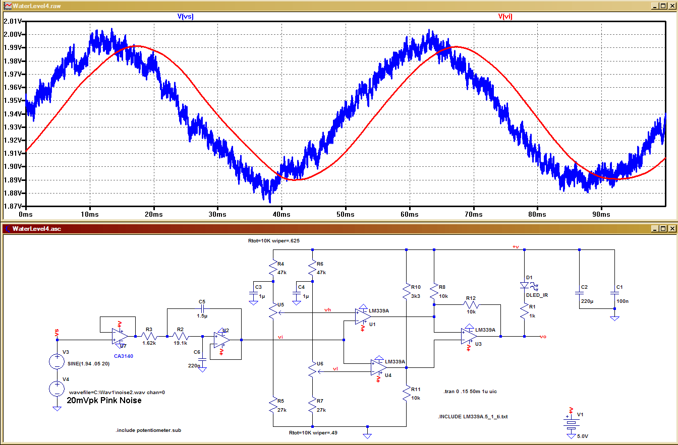

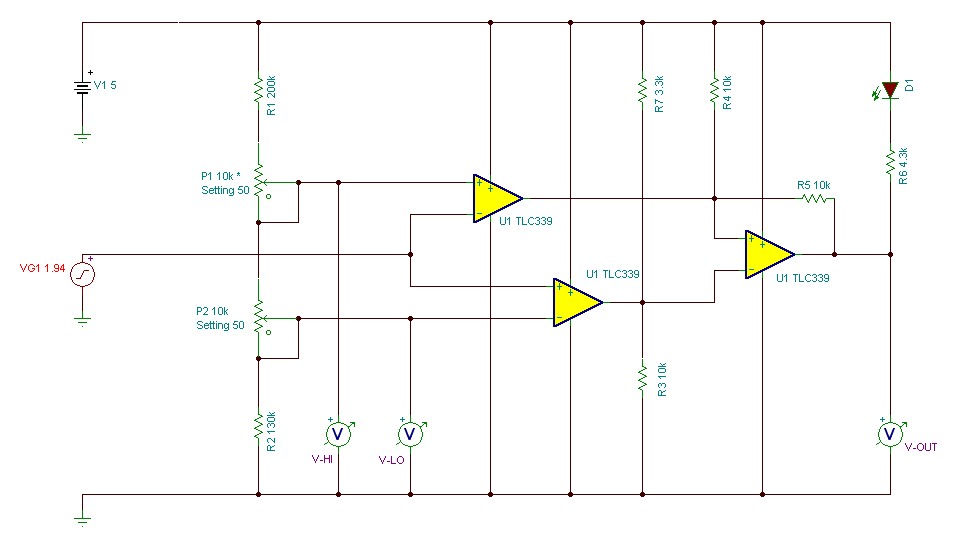

I've been trying to follow Ed Cheung's water meter monitor idea and have made some great progress but ran into trouble when I found that I had a bit more noise than he. His circuit works pretty well as shown on his web site though I did have to play with the value of the hysteresis resistor to get a clean transition. Even with that change if the meter parks itself near a transition point I have enough noise to falsely trigger multiple pulses.

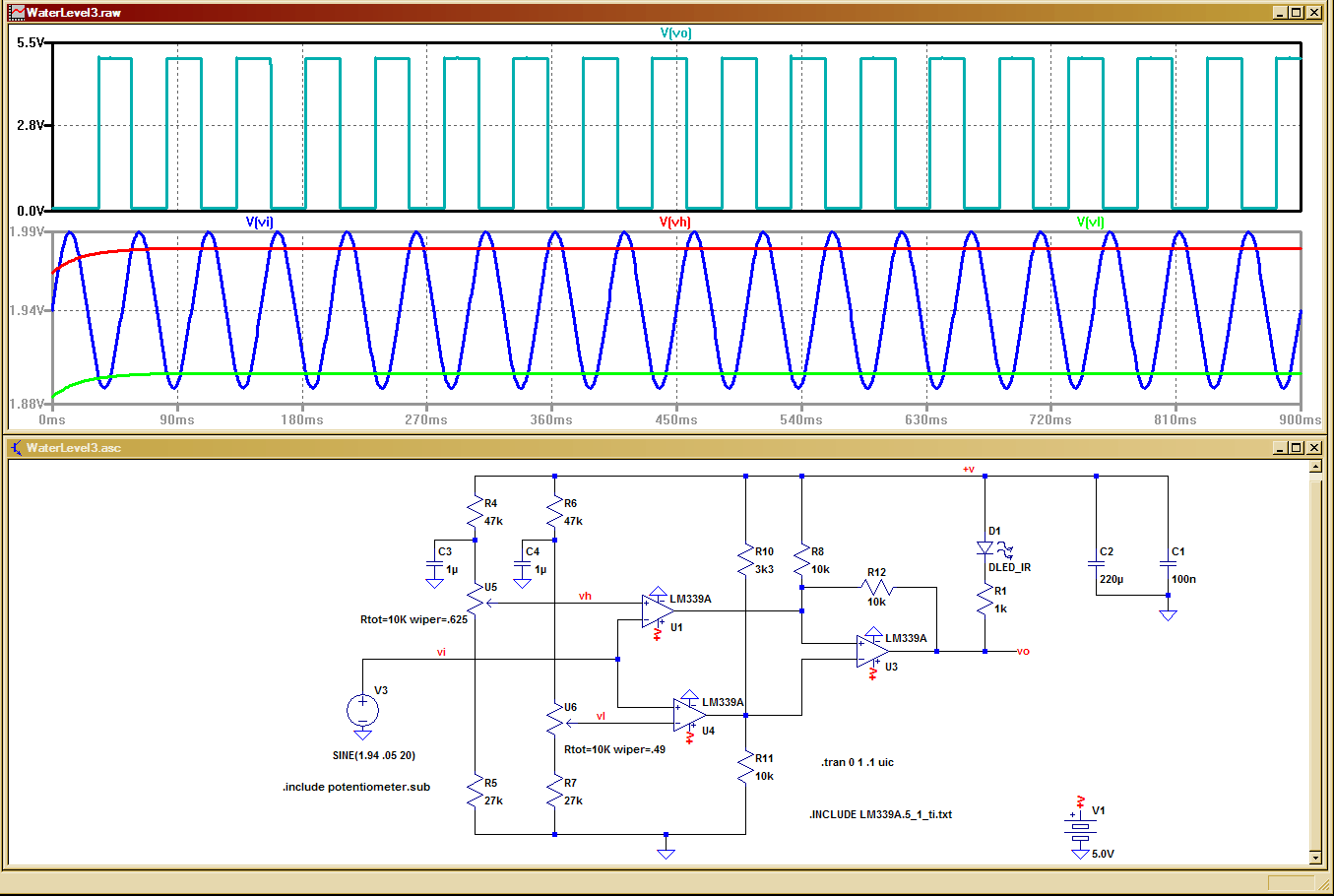

So, I thought I'd get fancy and put two more of the LM339's comparators to work. I figured I'd use one as an S-R flip flop with S triggered by the HI side of the sine wave as detected by one of the comparators and the R triggered by the LO side of the sine wave detected by the other. The idea being that at most I'd get single pulse a bit too early as the noise would be unlikely to reach all the way down to trigger a reset.

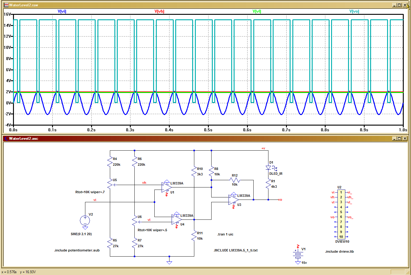

I did a simulation of the circuit using TI-TINA and got some promising results so I decided to build it. The first problem I ran into was the voltage divider. The input signal is a sine wave going between 1.89v an 1.99v and from 0hz to 20hz. The signal range has been constant and the frequency changes (as expected) with water usage. So, I need a voltage divider that will let me set the two outputs to around 1.90v and 1.98v I'd like to be able to adjust both independently or even better pick a center point and a width. On paper what I have looks great. In practice it just doesnt seem to come out right. Tweeking the large value resistors on either end to let the pots do their fine tuning thing is a real exercise in frustration. There's got to be a better way.
Any and all comments on the voltage divider or the circuit in general would be greatly appreciated. ...oh and did I mention I dont know a thing about circuit design?

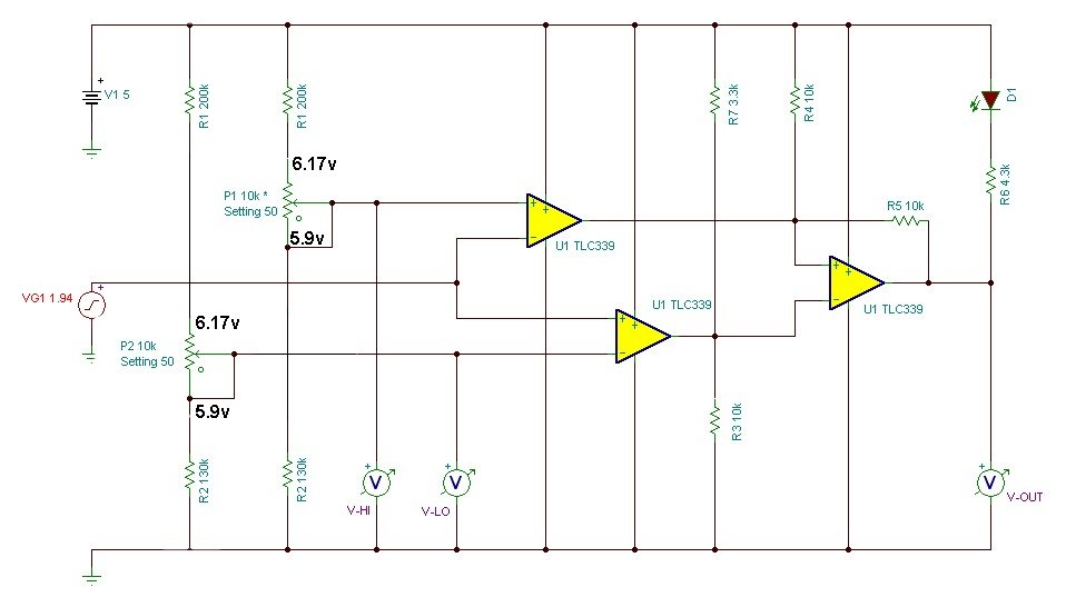

Looking at that circuit, trying to set the threshold of the two comparators when using the same resistive divider chain will be close to impossible.
I have added a second divider on this circuit, using the existing resistor values, as you can see the threshold are well out of the range of your input signal of ~1.9Vac.
I will post a revised circuit later today.;)
This LTspice circuit shows the resistive dividers for the required thresholds.
Ideally the pots should be 20turn or 2K for precise settings, if you do use a 2Kpot , change the series resistors to suit.
I have not changed the rest of the circuit, but IMO some improvements could be made.

I wasnt very clear about the nature of the signal and the supply voltage. Vcc is only +5v not 15 (the battery was labeled V1 with a value of 5). Also, the input signal ranges from +1.89v to +1.99v. The first two comparators are trying to catch the tops and bottoms of the sine wave.

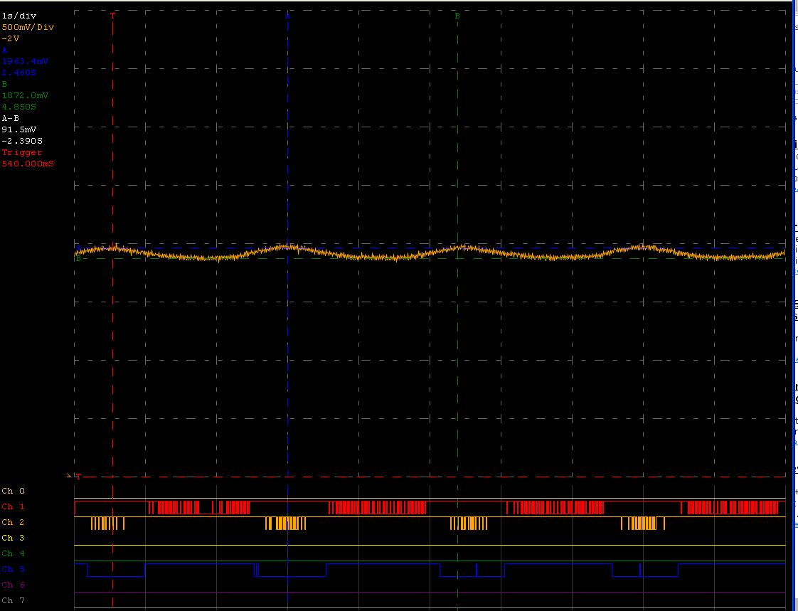

Noise from the signal is still a problem. It's starting to look like I have small spikes that span the upper and lower limits. I would have expected this to have been a problem when I was using a single comparator with hysteresis. Should my two limit comparators be configured for hysteresis? On the other hand, wouldnt this noise show up on the scope?
I've attached a screen shot of the noise. The water is running at a bit more than a drip so it's less than .1hz. Ch1 and Ch2 are the inputs to the flip-flop and Ch5 is the output. Perhaps what looks like clear logic levels to me, are widely different voltages to the comparators.

Normally when you use comparators you also use some kind of hysteresis. You should incorporate at least some.
Also, if the noise is very high spikes you may also need some capacitive low pass filtering. That should be simple here because you dont need high frequency response.
Power supply bypassing is also a good idea.
The set point pots would also have caps from center to ground.

The +5Vs compared to a +15Vs will make a big difference to the circuits operation.
When you say the input signal ranges from +1.89V to +1.99V, does this mean a sinusoidal signal of +/-0.1Vppk sitting on a DC level of +1.94V.??? [query point]
The noise could be coming from your power supply and/or the dividers, the circuit doesn't show any decoupling capacitors.??
As you can see there is hysteresis applied on the output OPA, I would suggest that you consider a low level of hysteresis for the Hi/Lo OPA's.
If you confirm my query I will redo the circuit for +5Vs and that waveform.
BTW: I did sims to confirm that the circuits works OK over 1Hz thru 20Hz

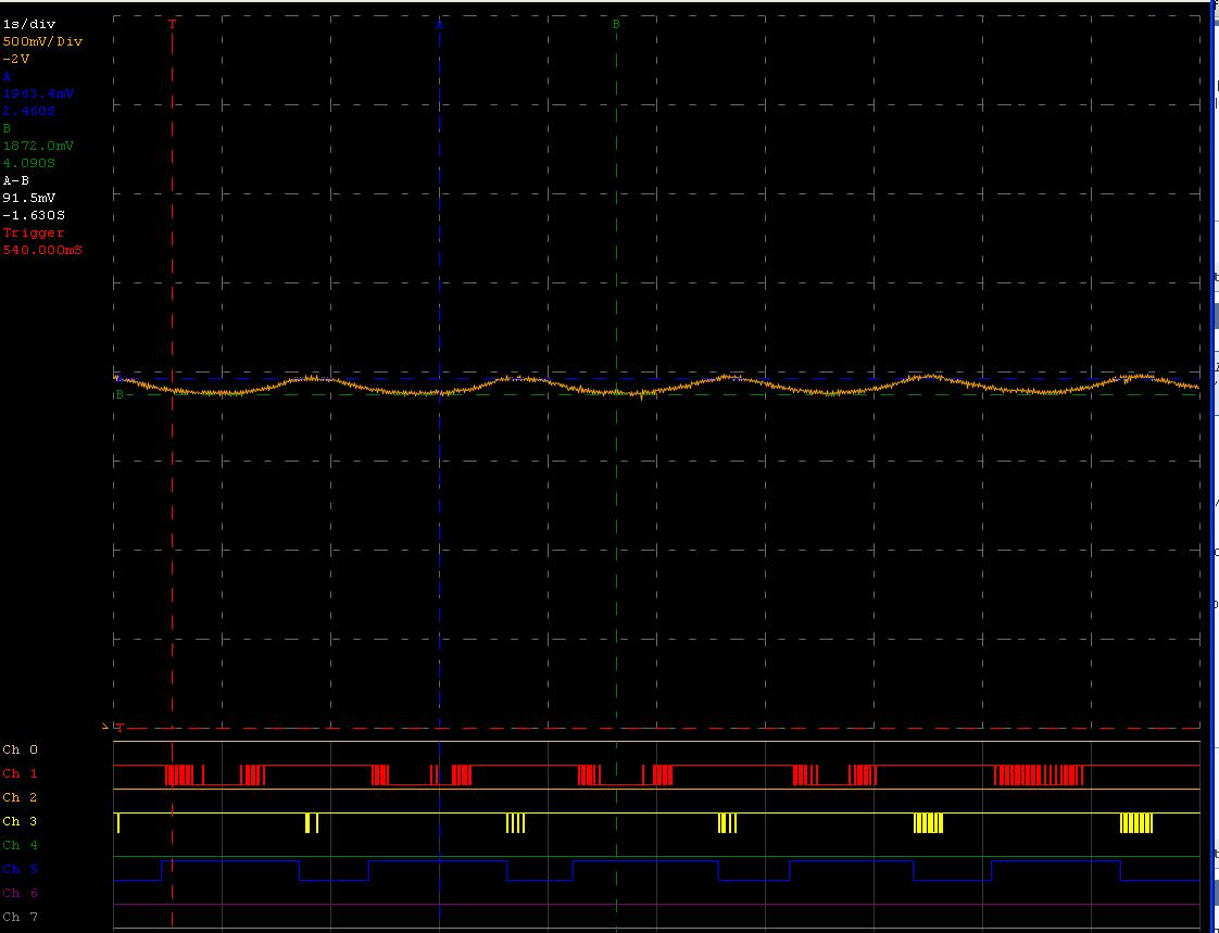

This picture shows about how I expect the circuit to operate. The spikes on Ch5 (the output) are what I dont expect. On occasion, the noise is high enough to span the setpoints, but that doesnt seem to explain these. Also note that 0hz is a valid signal. It just means that no water is flowing at all so there there should be no changes in the output at this time.

Your image of the signals shows that input sine wave is very noisy.
The problem we need to avoid when using hysteresis is that we dont want to change the threshold window too much,,, I will have a ponder!
Will look at your link.
EDIT:
I see that Ed's Hall effect signal trace is also very noisy..
I would suggest that you add a very low pass filter OPA, between the sensor and comparator inputs.
Will run a simulation, let you know.

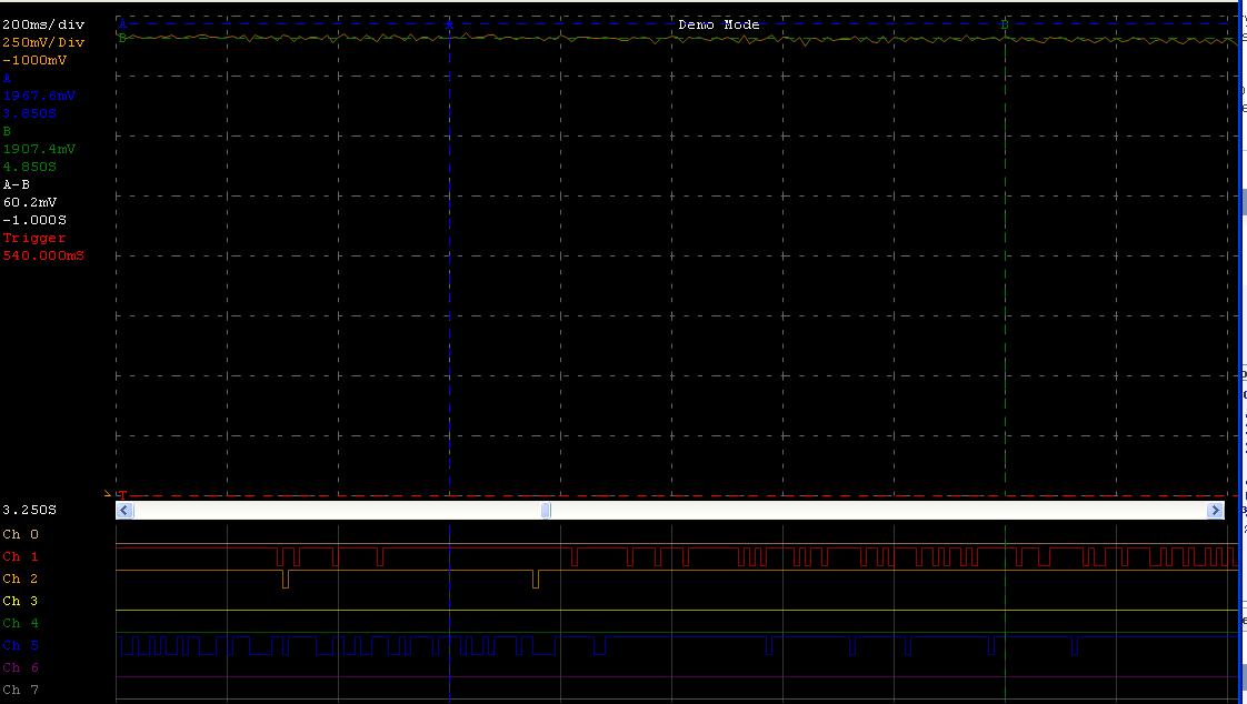

Here's another picture showing some noise at 0hz. Again, this is just what I'd expect on Ch1 and Ch2. The signal is near the top and on occasion, the noise puts it over. But, the output, Ch5, is already locked in that direction, so there should be no change. There is a big noise spike in the middle that hits both the upper and lower set points. Here I'd expect (but would love to eliminate) a false output pulse.

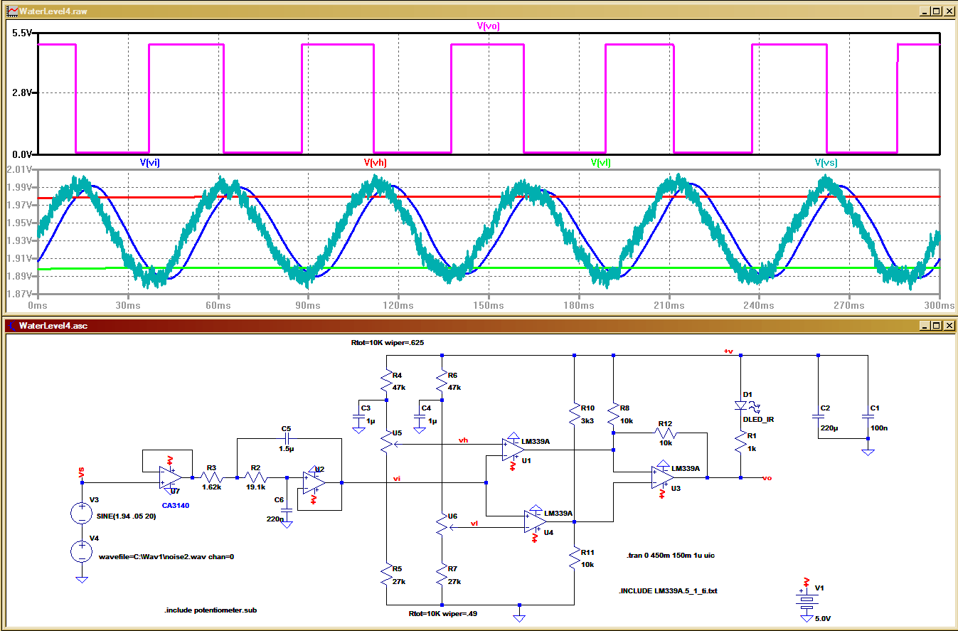

This circuit has a Sallen-Key 2pole, 50Hz cut off freq on the input
Note the reduction in noise [ which has been added to the signal, ie 20mV pink noise]

Eric,
That sure does clean up the sensor's output quite a bit. Thanks! Sadly, I'm going to have to go shopping before I can test it out.
I am still having trouble understanding how my flip-flop output can see a change while the logic analyzer is not showing an S-R-S pattern on the inputs to the flip-flop. I am sure your filter would help quite a bit, but I still feel there is problem with the logic or the inputs to the flip-flop. Being new to all of this I could be relying on the scope a bit too much to tell me what's going on. From looking at my images, do you see what I mean? Do you think your filter will cure that too?
Is there any chance the fourth comparator could be used to filter the input? I'm trying to keep this as small and as low power as possible. Ultimately it will be powered from the +5v of my 1-wire network with the output pulses counted by a DS2423.
I'm getting closer. This picture shows how I'd expected it to work. The nice thing is, it's working as expected. I think it's still going to be important to control the noise a bit better.
It turns out the decoupling caps were the key. Per MrAl's suggestion I added caps from the pot's centers to ground. I also added caps between the limit detector's outputs and ground. All of the flip-flop's output spikes went away. As can been seen in this picture, the transitions are all clean.
I found an online calculator for building low pass R-C filters. On the sensor output I put 4.7k resistor with a 1uf cap. The noise level dropped noticeably. Can I do better without going to the complexity of Eric's filter?

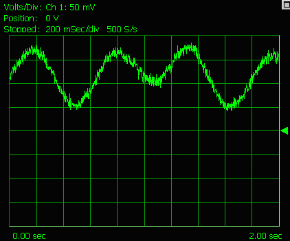

Finally received my sensor and took scope outside and played with it. This is powered up with a 12V wall wart + 7805 with no filter caps. So, it is a bit noisy.. Sorry for the bad pics didn't have a better way to capture the output.
Basically the amplitude is about 180mV. The top is 2.17V and the bottom is 1.99V..
So, with the circuit above work? I'm thinking that there will need to be some adjustment of the threshold?
