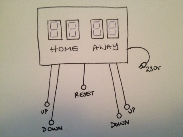

Hello, I am working on building my own scoreboard, but require some help. This is basically how I want the end product to function: idea.JPG. I'd like to make the 7 segments about 6 inch's high, the power to run off the mains and was thinking of using buttons as used on a pinball machine.

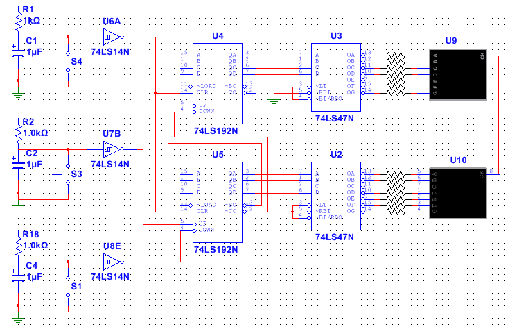

I have been browsing threads here and found 'this' schematic by hdc090360 that I think should suit the purpose, but it just needs to be tweaked to the specifications.
So far, I have altered and got a good understanding of how the scematic works and have come up with scoreboard_design.png so far in multisim. I haven't added the second group of lights as I figure its just a matter of attaching the CLR's (on the 74LS192N's) to the reset switch. As you can see, I have left out the power supplies and the values of the resistors. Because, simply I don't know how and was hoping you can please help with that?

R1,R2,R18 only provide a 1ms time constant when used with 1uF. They should have a higher value (say 30-50k) for better contact debounce.
74LS logic outputs can only sink 8mA. Will that be enough for your LEDs?

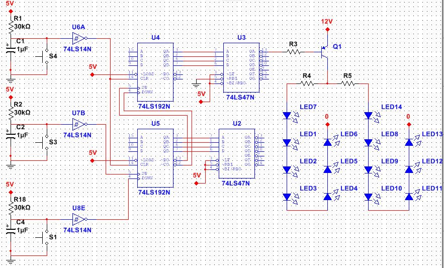

Further research indicates that although 74LS in general has 8mA outputs, the 74LS47 is an exception and can sink 24mA. Sorry if I misled you. I can't recommend any particular LEDs. Red LEDs in general have a Vf of ~1.8V-2.0V (other colours have a higher Vf). The 74LS47 output transistors can withstand up to 15V apparently, so if the LED supply voltage were 15V the maximum number of LEDs in series that each ouput could drive would be 15/2 = 7 (but that would leave little headroom for current-limiting). So you would need 2 strings of LEDs per segment, which would restrict current to <12mA per LED.

You can buffer each output of the 74ls47 ICs with a PNP transistor in emitter-follower configuration. You'll not have any issues with output current then
I agree with dougy83. You would still have to be careful not to exceed the 74LS47 output transistor voltage rating.

So Dougy83, the buffer given will allow for a stronger output to run the LED's? Wouldn't that require a transistor for A,B,C,D,E,F,G on each of the 74LS47N's?

Yes, it requires a transistor for each of the outputs of the 74LS47s
It's not what I was referring to, but yes, something like that will work.
Hang on a moment, wouldn't that require being an NPN formation for how I have drawn it? being a current from the 74LS47 signalling the 12V current to pass to the LED's?
The output of the 74LS47 is an open-collector transistor. When it is on (LOW), it pulls the output towards 0V, which will turn on your PNP as you have drawn it.

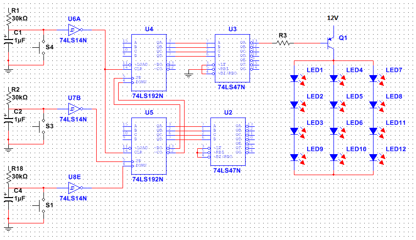

You're nearly there. Each LED string should have its own current-limiting resistor. Without that, because of LED manufacturing tolerances, you might find that different strings have quite different brightness. And yes, the 74LS logic needs a 5V supply.

Thanks alec_t, that makes sense. What I shall do now is finish drawing it all up and come up with a specifications list. Then, I will need some help with working out the values for the resistors and other components. But, I am really happy to see it all progressing well and that I am learning so much. Very big thanks.

Hoping I am on the right path here.
Well each string now has 7 LEDs, so the 12V supply isn't high enough :(
Alec - you just had to go and pop my bubble, hehe. Wouldn't I need to base the voltage anyway on the type of LED's I shall be using? Like if I chose one of a higher MCD? Thanks.
