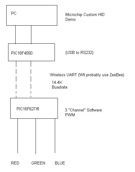

Basically the pc sents 5 bytes of data. The first byte is the start byte and is 14 Hex. The next three bytes is each an 8bit "color" byte. The last byte is an "master control" byte, which controlls the total brightness of all 3 colors. (I'm still working on that)
Block diagram:
The diagram pretty much explains all. Ok so the pc sends 5 bytes via USB. The 18F converts and sends the data to the 16F. This will be wireless. The Buadrate is 14.4k.
The 16F uses a "3 channel" software PWM, found on this site. I could'nt found the link, but it was done by Mike McLaren K8LH.

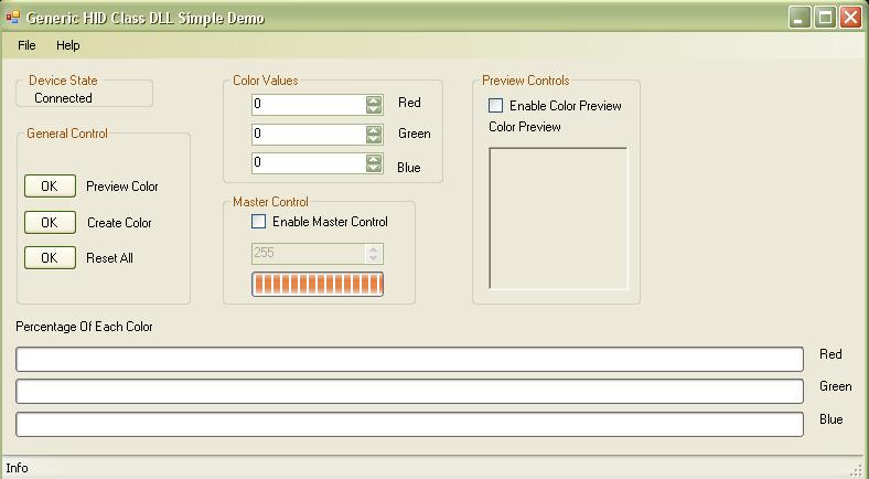

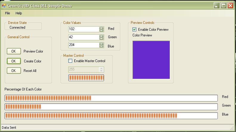

Here are 2 screenshots of the program on the pc.
The color values is selected with a numeric up/down "counter". The percentage of color used is displayed with the bars on the bottom. You can also preview the color on the right, before you "create it"

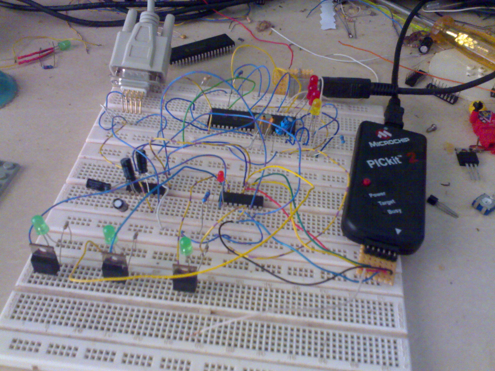

This is the "devolepment board". Unfortantly I don't have an RGB LED. I hope to get one soon and test if this thing really work. Currently I test the voltage over each LED to determine if it's less bright when I can't see the diffenrnce.
Just to let you know. The 18F is programmed with a bootloader found here: eegeek.net - 18F4550 USB Interface
I've also used their schematics for the 18F layout.
