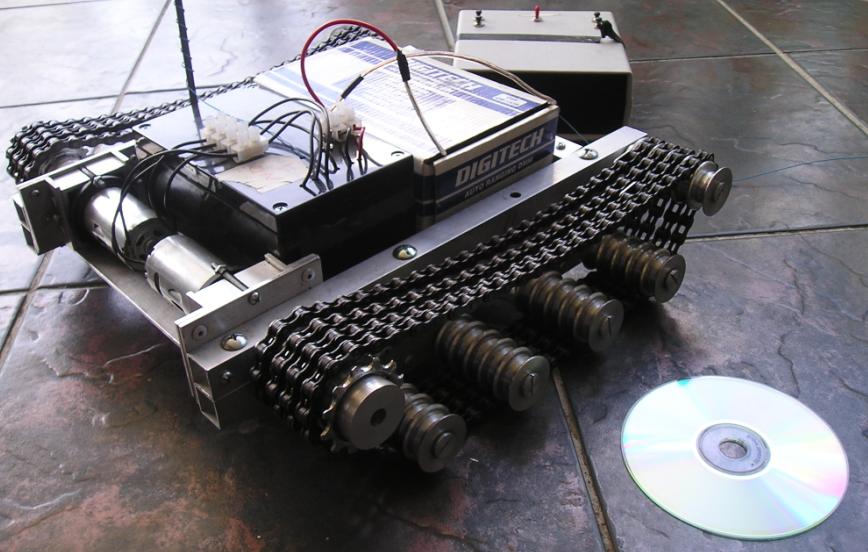

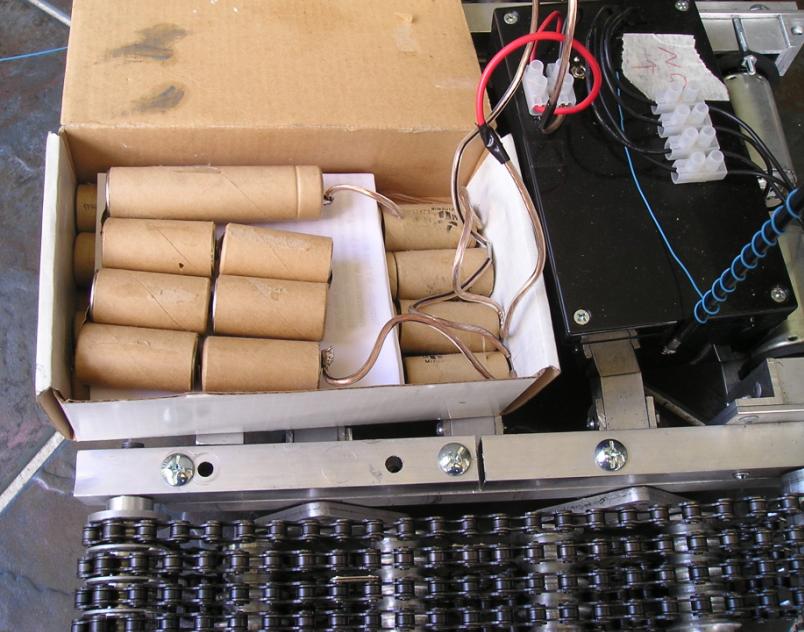

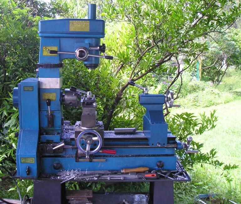

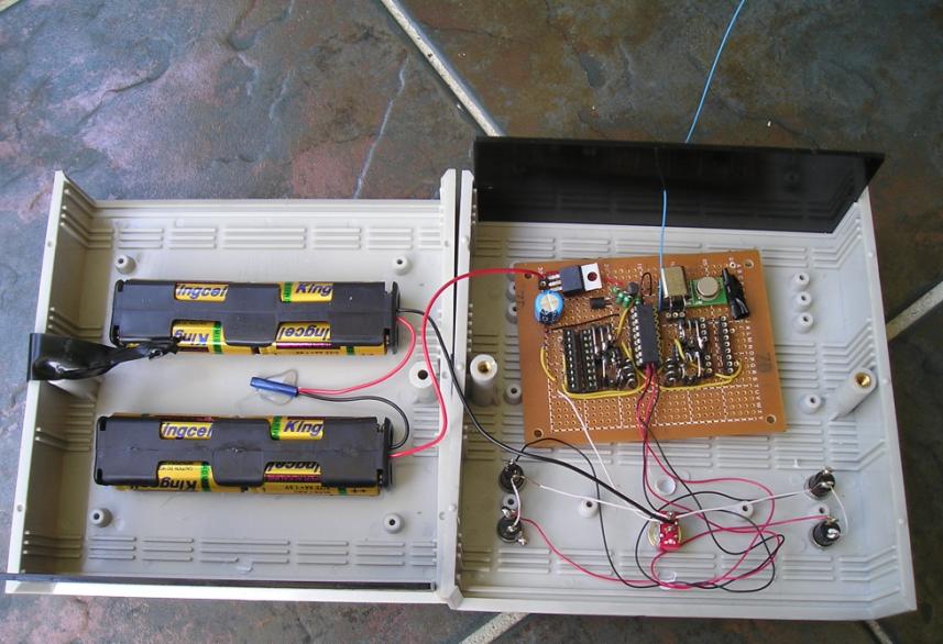

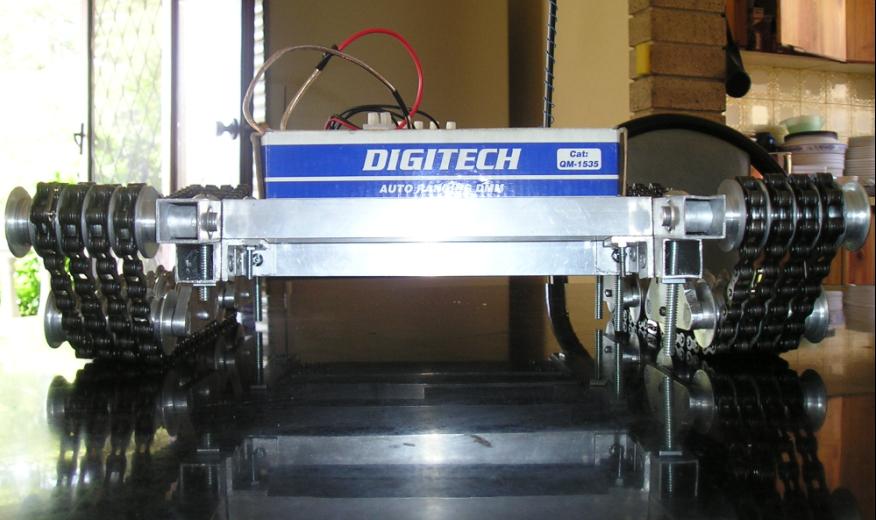

This is my rc tank that i built together and designed : Admins move this to robotics if nescessary.

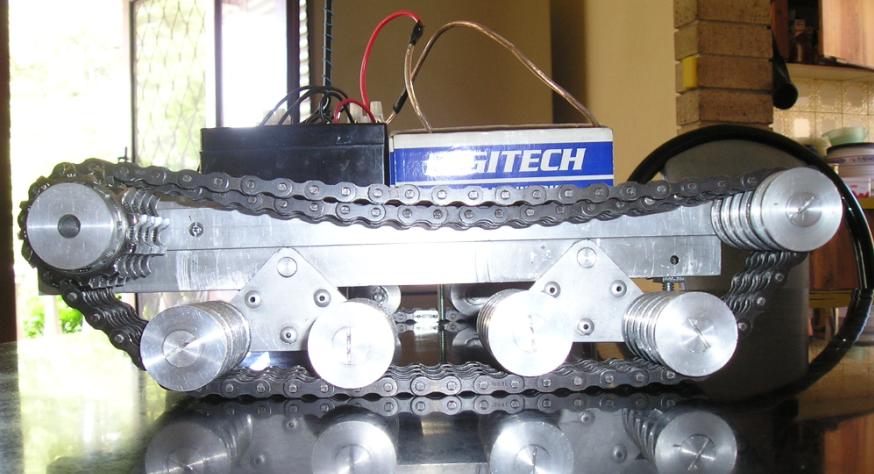

It runs pretty nicely actually. The suspension does however sometimes lock> it is a snack to run. Speed?? about 90m per minute.
*the neighbours can finally get some sleep.
Nah my cheappy camera cant take videos and it doesn't have a zoom function either. So it kinda stuffs it up when i want a closeup. but you cant see anything cuz my shadow is there.
I thought of that chainsaw blade idea but each chain costed $22 each. alot cheaper to use the $4 bike chains. There is almost nost traction on tiles and concrete. On grass though that is a different story!!!

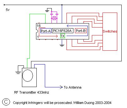

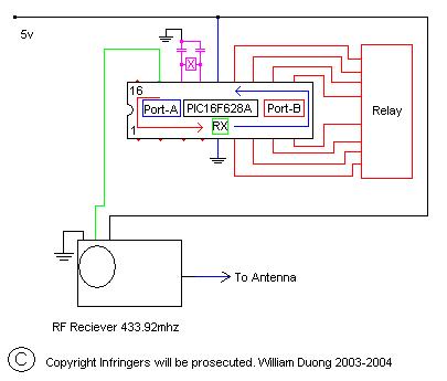

These are the 2 webpages that i got my infromation mainly from. The principal in how the information is transmitted is just about identical.
Judging from your location you are interested mainly in the radio transmitter/receiver end yes??
RFmodules my friend 8)
O.K i found some of the diagrams that I drew along time ago:
These licence free radio modules are excellent!!!
pike said:
http://www.lpilsley.co.uk/cybot/tx_picboard.htm
Interesting you used my old Cybot radio plans :lol:
It's not really a very good example of how to do it, as it uses plain (inverted) RS232, with no coding at all - but for this simple application it works fine, because it simply transmits the data continually.
Yeh i know its not the best way to transmit information. Range is somewhat limited compared if you used a shielded enclosure.
I didn't actually use your code to write it. I wrote it from scratch.
Thats why now i want to switch over to the amatuers band. and use higher power devices while staying in the limits. Thats why alot of remote control toys operate in this frequency range here. less power restrictions means more range and less malfunctions.

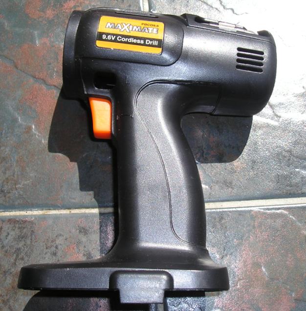

anyways those motors of yours, you got them from drills as you say, yes?
but what gears do you use? the same the rdill had or bought new ones or made yourself? i plan and hope to do something also in the summer and now i'm cathering information on everything...

hi bloody-orc, the drills already come with the gear reduction setup. I roughly spent $400 US on the whole project. Although come to think of it the cost of materials is $240; Wasted $160 in the electronics department developing the RF signals It was a huge step for me in the microcontroller field however.
I got those toothed cogs from my local bike shop. I had to get them ordered in for $9 US a piece. Thats ten there ($90!!!). To control it i made a RF transmitter. This is where most of the money drained away because i didn't follow the manchester coding required for the RF modules.
Lesson learnt- listen to nigel when he says 'use manchester coding!'
honestly though i kind of regret the project because the end product serves no practical use. It doesn't defuse bombs for law enforcement agencies, it doesn't destroy enemy terrorist radar systems, it's useless.
I was thinking of somehow remote controlling my lawn mower to stop my mum nagging me to do the lawn, or to do my home work blah blah blah... :( Or atleast make the chores more fun.
Pike would it be more useful if you had used tires??
i mean it probably slips a lot even when on concrete..
i'm sure you could devise some sort of rubber to grip the ground more.?..
