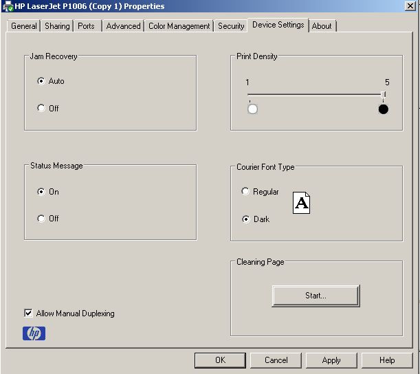

This is not my first pcboard but the first one after I replaced my toner cartridge. I tried getting the HP toolbox but no luck. Went to the PULSAR website and found a link to some down loadable software to be able to configure the printer settings including density. Anxious to try another board as the configuration software showed the density set to 3 not 5 as it was with previous cartridge.
Started designing a daughter board to test out the new settings. MOST of my previous boards are very nice crisp traces with no mistakes.I worked out all the bugs with old toner cartridge in use. Its frustrating to have a wrench in the works. As for testing the pictured board, located a test sequence over at Digital Electronics Forum • View topic - A TAP-28 Rev A Test Program. Have yet to rework for a 4520 pic.
What printer you use? I use the HP P1006...
printer-jpg.48684
using an HP Laserjet 1320 that I got for FREE with a toner cartridge that had 58% of toner still in it.
I got a link to printer configuration settings from PULSAR site
victechsoftware.com | LJConfig
now just need to make a board using a higher #5 print density. I guess when I changed toner cartridges it reset the density back to 3. Also changed the dpi from 1200 back to 600

My P1006 is awesome. I get perfect prints all the time. I use both Toner Transfer and Magazine paper. Both with great results.
