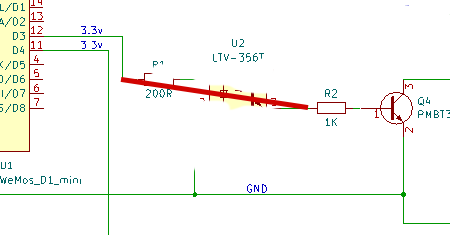

Hey all this would be my first try at creating a schematic in KiCad.
The schematic is a basic 2-channel relay.
The inputs are automotive 12v and gnd. This gets converted to 5v by the K78L05-1000R3.
The Wemos D1 mini has 2 digital pin outs that are 3.3v going to the LTV-356T with a 200 kOhms resistor in between.
From there it goes to a 1k resistor and then to the PMBT3904. Between that and the G5LE-1 relay is a 1N4007F.
In that same area is another 200 kOhms resistor that’s connected to an LED.
The outputs and inputs are the 2pos and 4pos 3.5mm Pitch Terminal Block Connector 300V 8A.
Just want to make sure my values are good and the components I have selected are suitable for my application. Please let me know if I am missing anything or have a value incorrect. Thanks!

R1,3 should not be 200k. More like 200 ohm. R5, R12 please check 200 or 200k.
Automotive power is not 12V but more like 14.5V when the car is running. There can be some real voltage spikes. I usually start out with a diode so only positive current can flow into the project. People put a jumper cable on backwards all the time. I see backward batteries.
What is U2,4 doing. I see Chinese relay boards where they say the board has opto-isolation. But just like you circuit there is no isolation and no need for any. What is the coil current in the relay? I think the micro can drive Q4 with 200 to 1000 ohm directly.
1. Both sides of the optocouplers share a common GND and Vcc. Therefore, you can eliminate both. 3.3 V is more than enough to turn on a 2N3904 as a saturated switch.
2. Q1 and Q4 both need base pull-down resistors to assure rapid and complete turn off.
3. The LEDs are shorted out and will never light.

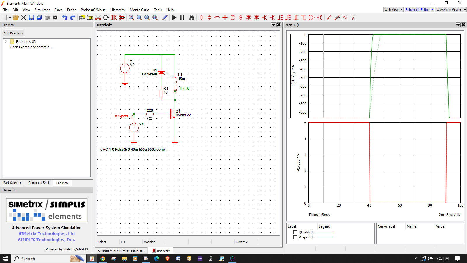

Would you mind showing this? A visual would be great
Seems like a R in series with diode slows down turn off in the
solenoid. Solid curve R = 0, dashed 10 ohms.
Regards, Dana.
I have error in post #11, actually R does improve turnoff. Here I did it with 50 ohms,
solid curve is 50 ohms, dashed 0 ohms
I found that the collector with 0 ohms in series with diode, max Vc was 6V, when it is
50 ohms max Vc reached +30V, very narrow spike. No LED reverse V though, collector
was always > 0V.
Regards, Dana.
What is your reason for having two optocouplers in the circuit?
This is what happens when somebody cross posts to multiple forums. Changes are made elsewhere, and when they pop up suddenly here, there's no clue why.
As I recall, in past times here, cross posting was actively discouraged. It is rude, leads to confusion and incomprehensible threads and wastes the time of anybody who might answer.
The peak voltage on the transistor will be increased by a factor of R100/[relay resistance] so you must make sure that the peak voltage is still less than the transistor maximum Vce.
The resistance of the G5LE relay is 39 Ohms. The current at 5 V is 128 mA. When the transistor turns off, that current will flow through R100. If R100 is 220 Ohms, that will give a voltage of 28.2 V across R100. The voltage between the collector and emitter of the transistor is that 28.2 V plus the supply voltage plus the diode voltage, so about 34 V. That is OK for a transistor rated at 40 V or more.
The resistance in the freewheel circuit is 39 + 220 Ohms, which is 6 - 7 times larger than it would be if the diode were directly in parallel with the relay coil, so the current in the coil will reduce about 6 - 7 times faster.
The LED current is limited by both R100 and R101. If the LED voltage is 2 V, R101 is 0 Ohms and R100 is 220 Ohms, the LED current is 13 mA. R101 can be increased to reduce the LED current if required.
The connection with R100 and the LED in parallel with the diode instead of in parallel with the relay coil prevents the reverse voltage spike of 28.2 V being applied to the LED.
In your application it may not matter if you turn off the relay coil slowly. It will still appear instant to someone watching. The curves in the data sheet show that the life of the relay is reduced quite a lot as the load current goes up, and inductive load reduce the life.
