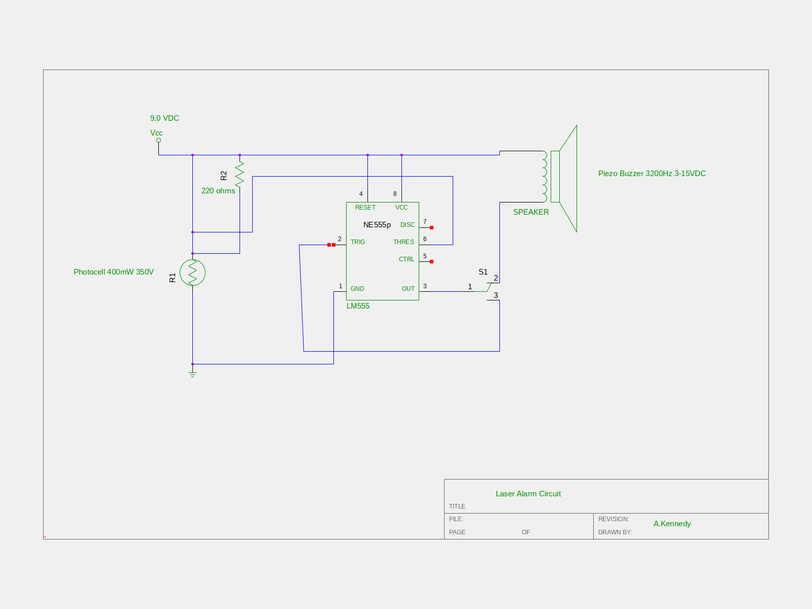

My circuit as created by Geda

Your schematic is a negative image that is too small with colored lines and text on a black background. Nothing can be seen.
Thank you for fixing the schematic so that it can clearly be seen.
Does the circuit work properly?
You are most welcome. It worked fine on the breadboard.
After soldering, it beeps all the time.

The circuit cannot work as shown. You have the Threshold input tied directly to Vcc.
What is S1?
