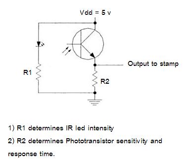

You are right about the radioshack not having much data, but they are the most convenient for me. I did try the setup you suggested and SUCCESS! Well, sort of. I had to play around with the BS2 to set the rang for the I/O states.
I posted the circuit I am using to test below, if anyone is interested.
I am playing with the value of R1 and R2 now to get the desired response. I a having some difficulty with it detecting fast objects. Would there be any real advantage to using another transistor?

If I did the math right, your paintball will be moving at 4us/mm. This may be a bit short time to detect with a photo device.

You are right, at about 800 fps that is about 4 us/mm. The actual limit is closer to 500 fps which is around 6 us/mm. I am open to suggestions. I know that the chronos available use an optical switches but I am unsure of what configuration. Do you think a photocell might be more fitting? I would think that a photocell would be far slower. I also know that photo diodes have a faster response time. Seems like there should be a way to use a photo transistor.
I have not worked with many photo devices, but I would think a wide angle receiver would be needed.
You may be in luck.
Another transistor will not speed up the circuit. But if you make the phototransistor emitter resistor low enough to get the desired speed, and the signal level is then too low, you can add a transistor to amplify the level.
What value of phototransistor emitter resistor are you using?
Any photodiode will likely be fast enough for you needs. But you will need to add an amp to get sufficient signal level (Google "photodiode amplifier" for some examples).
Now I am using anything between 68k and 1M ohm as the phototransistor emitter resistor, above or below that falls out of the range for the bs2. That's why I had imagined using another transistor to amplify the signal as you said. I need at least 3.4 volts for the stamp to consider the circuit "on", below that is considered "off".

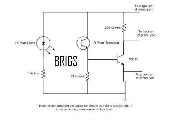

I did find this today (link below), the only difference is he is using a 3 pronged phototransistor. I do not have enough knowledge as of yet to know if I can adapt this circuit using the components I have.

I did get the circuit working with a small signal transistor. My best combination so far is a 22 ohm resister on both the em miter and on the IR led. It can detect up to about 200 fps above that I am still having difficulty. I guess the smart thing to do would be to buy some pots so I could potentially zone in on the correct values. It would also help if I had more information on the shack stuff I am using.

Did you mean a larger resistor would slow the response to change in the ir light?
Yes.
You can use the circuit you found in the link. He's not using the base connection to the phototransistor, so you just ignore it.
yeah, I figured as much and tried and it did work. I am still trying to zone in on the best R1 and R2 values. Did you see the link above?
Look at the risetime spec for your phototransistor. Some are slow. I have seen 40us rise times for some devices. This would be too slow for your app. Use one with fast rise time spec.
