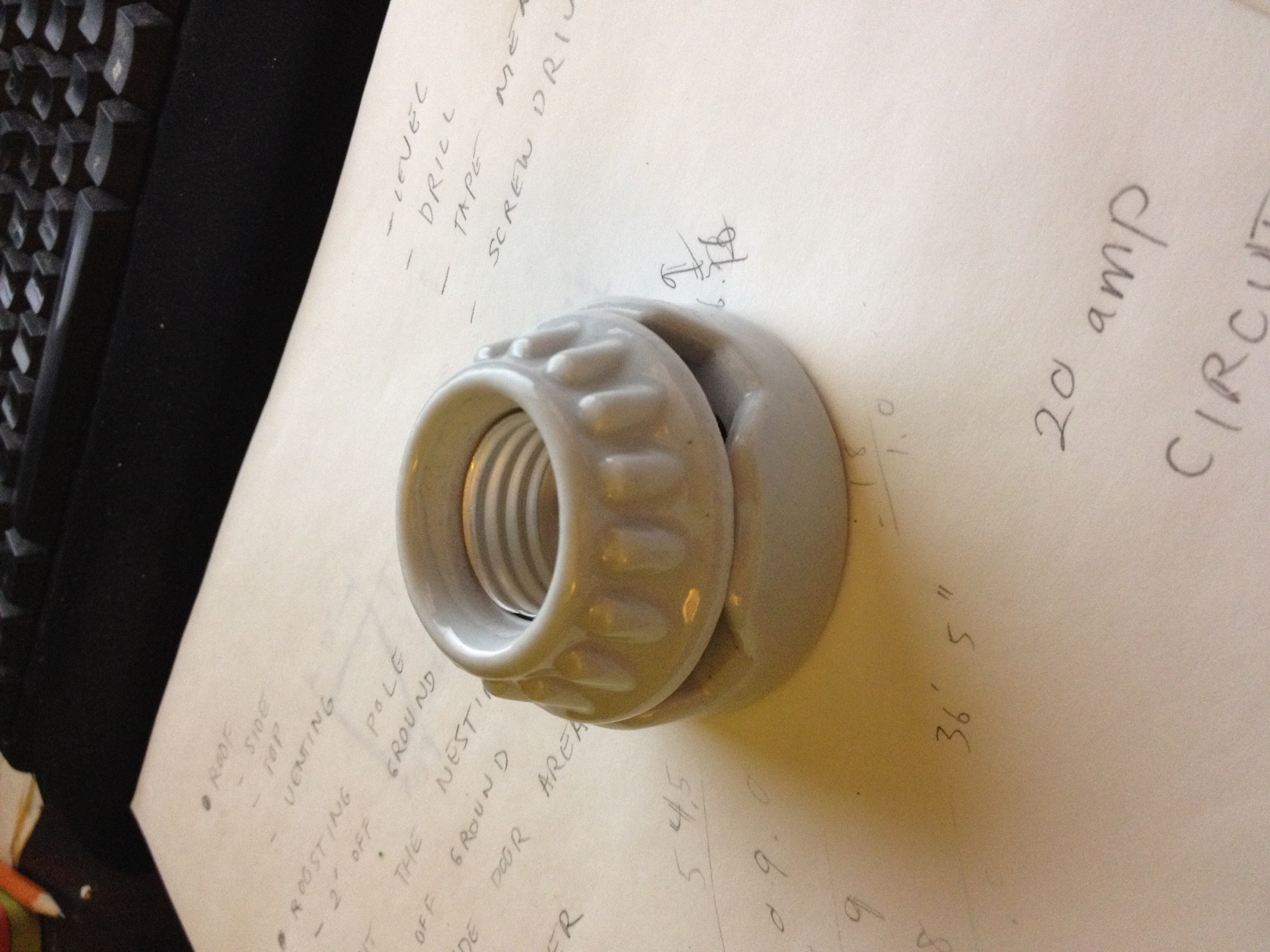

I'm knew to this forum and you guys are my only hope. I am working on building a replica or close to replica of the Muppet Arches from the Muppet Show. In the image below you see a bunch of lights along the arches. I want to do that exact thing. My replica will have a total of 3 rows of arches equaling 139 total bulbs. I am in the US and there are 4 outlets that I can plug into. I do not have access to hard-wiring my project if that makes sense. All I do know is the gold sockets used are porcelain sign receptacles painted metallic gold. How would I start? Where do I start? I could use any help I can find. Thanks guys.

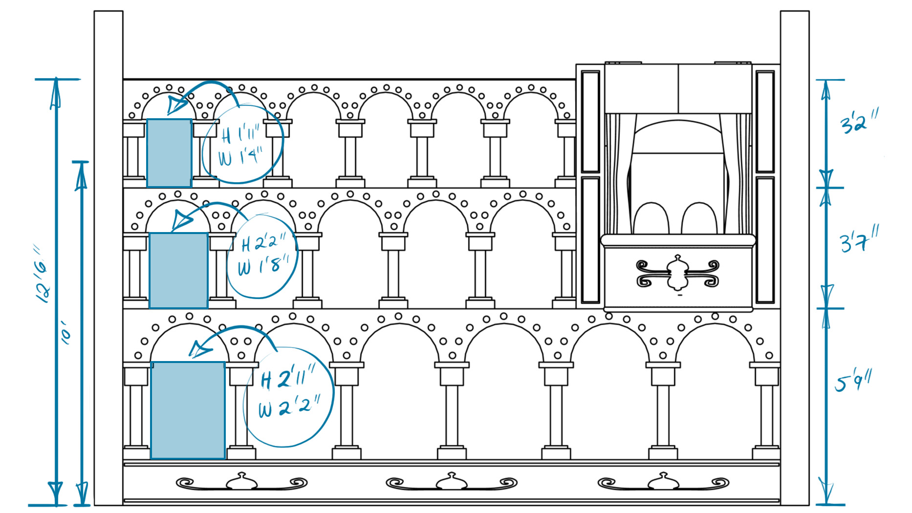

Yeah I think 7w CFL's should do. I don't know what a sequencer is but that could be a great option because it's not essential for the lights to come on at the same time. I've thought about having a light source inside the arches and having fake bulbs but I have been so wanting to make an authentic replica of it that I ditched that idea. For all of those helping out, here is a front view of my plans.
UPDATE: The facilities guys here at work gave me more info on those outlets. The studio runs 20 amp outlets instead of the 15 amps. 4 outlets and each of those are wired to their own circuit breakers according to my source. He is going to look at the building plans to find out exactly what is going on especially if they are sharing circuits with the offices on the other side of the wall.
plans.

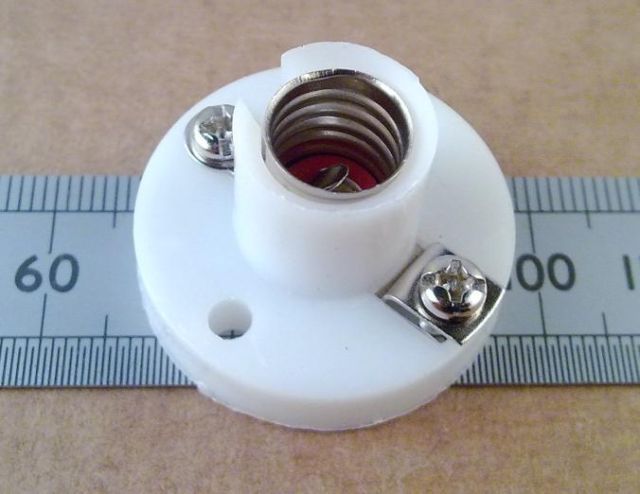

In hindsight these are probably too small, they hold mes type torch bulbs.
The above picture is the receptacle for the bulb. What gauge wire do I need to get and how would I daisy chain all the receptacles together? And what kind of a plug will I then connect all the receptacles too? 2 prong? 3 prong?
