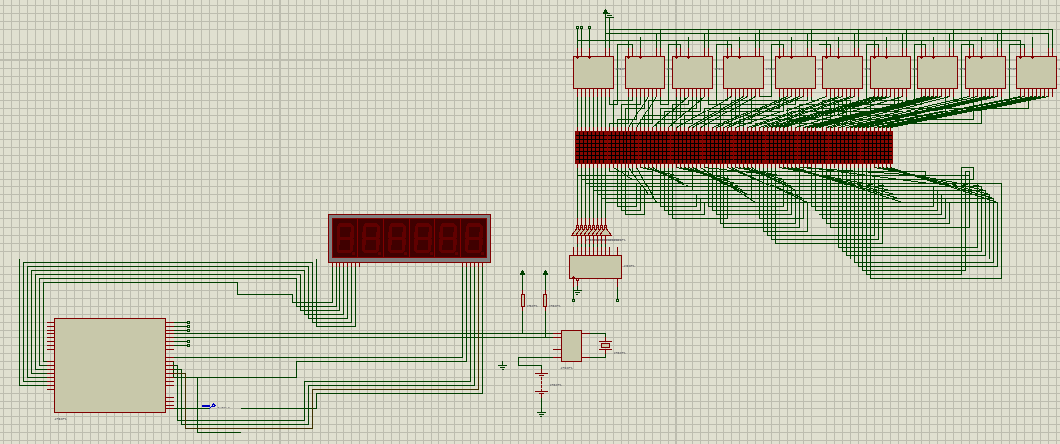

Hi Goodday everyone. Pls can someone help me with a code to multitask two events with Interrupt routine on mikroc. Thank you

john like i just explained up der. i wrote a code for a clock(using 7seg as display) and calendar(using dot mat as display) both reading its data fron ds13067. Each one is in a function of its own. When i try calling them into void main. one makes the other one not to display for a while. so i want the two events to be steady. so pls how do i do it with PWM if its a better option.

Dumken,
Do you mean: "7-segment displays multiplexing"?
That is completely different thing and possible with all MCUs.
Better sign to MikroE forum (it is free), you will get help from first hand.

Nope thats not wat m saying. Ive done that already.
Yes, schematic and code would be nice.
However, what I understood from what you have described do not require RTOS....
With most of MCUs you can do one thing at the time - it is simple low speed hardware.
Like suggested earlier, you don't need (or want) 'multitasking', it would be a complete and utter waste and make everything run much slower. You simply need to programme it correctly, and potentially use interrupts (although it could easily be done without interrupts if need be).
One simple method would to use a timer interrupt to drive the displays (both of them) while the main programme simply updates registers holding the values. My multiplex LED tutorials do exactly that (in assembler).
Your application, particularly when using a DS clock chip, is pretty basic and only requires a VERY low specification processor - an 18 series is pretty massive overkill (not that there's anything wrong with that).

The pic18 has two interrupt vectors... Low priority and high priority... When using a polled display it is far better to service the display in an interrupt.... Set up the information you want to display in RAM, then let the interrupt copy the RAM to the display.... Nigel did a tutorial with two seven segment displays using a timer and interrupts... I have transposed the ASM to C so you can use it... Are you serially loading all you data to the display, or are you using shift registers??
I don't use MikroC for the small pics but I do use it for the pic32 so I can help porting the XC8 to MikroC..
The tutorial is here click tutorial 10....
i still have to make some certain modifications on it thu. What i want now is just home to make it stable.
At first glance, this code:
for(;;)
  Multiplexing();
  MatrixCalender()
What you actually do is to displaying on 7 segment displays then on matrix extremely often...
That is not how multiplexing should works.
It should not to do entirely one job then other, repeating that very frequently. You should split time for each fraction of the both jobs and execute these fractions, e.g. one of 7-segment displays, then one segment for matrix, etc..
From schematic is unclear what is what and it is actually sketch. If you have many 7-segment displays and use multiplexing, you should have that much transistors, or it is ICs driven...
Look at links other members provided for similar examples.
One of the "slow down" reasons is you call "MatrixCalender();" from the main AND from "Multiplexing()" surely you only need to call it once..
If you put ALL the data through a serial stream using latching registers you will get better control!
Furthermore, you read from DS1307 too often, that is certainly necessary to do only once, when device is turned on. Then use MCU timer to toggle on 1s.
The read isn't that bad... mS at most!! There would be more time checking "rollover" so I wouldn't bother!!
The BIG issue here is the time taken to update the LED matrices... The Matrices should be serially loaded and the 7 seg's should be latched.... Then you would have a good display!! I have shown you the way I do multiple LED matrices...
I posted some C code in another of your threads...
Let see...
3 x DS1307 reading +
6 x 10ms delay for "multitasking" SSDs +
constant chr2int() conversions +
rest of the code
) x Number of main loops in 1s
=> there is simply too many things to improve and everything will work fast and smooth and low main CPU frequency.
The main issue is initial approach.
