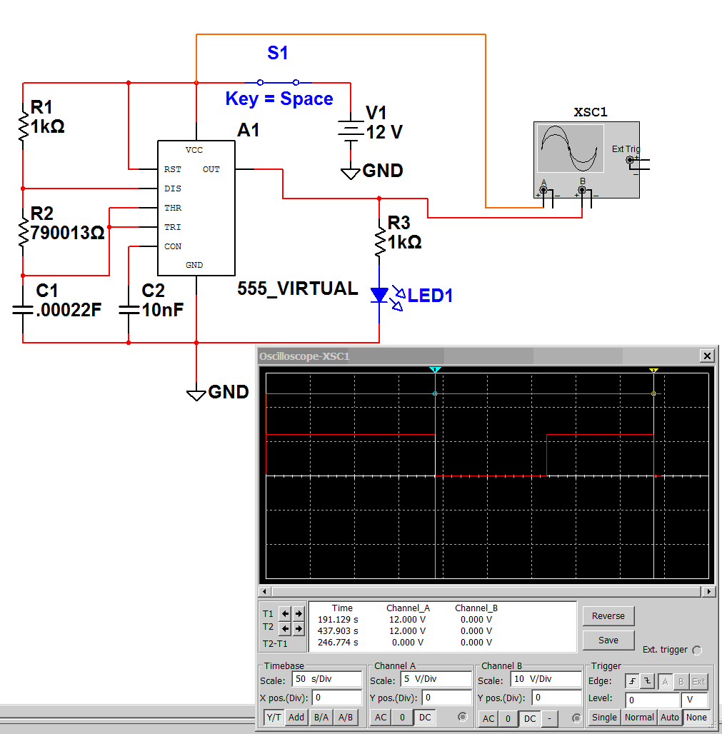

I am trying to use the 555 timer to light an led high for 2 minutes and low for two minutes and i feel like my math is right but when i simulate it in multisim it is not working correctly. I have used the 555 calculators and have done it myself but its still not right in multisim does anyone know why this is and maybe how to fix it. Thanks Dylan
Post a schematic of your simulation.
this is it the problem is that the high and low times arent what they are supposed to be in multisim.

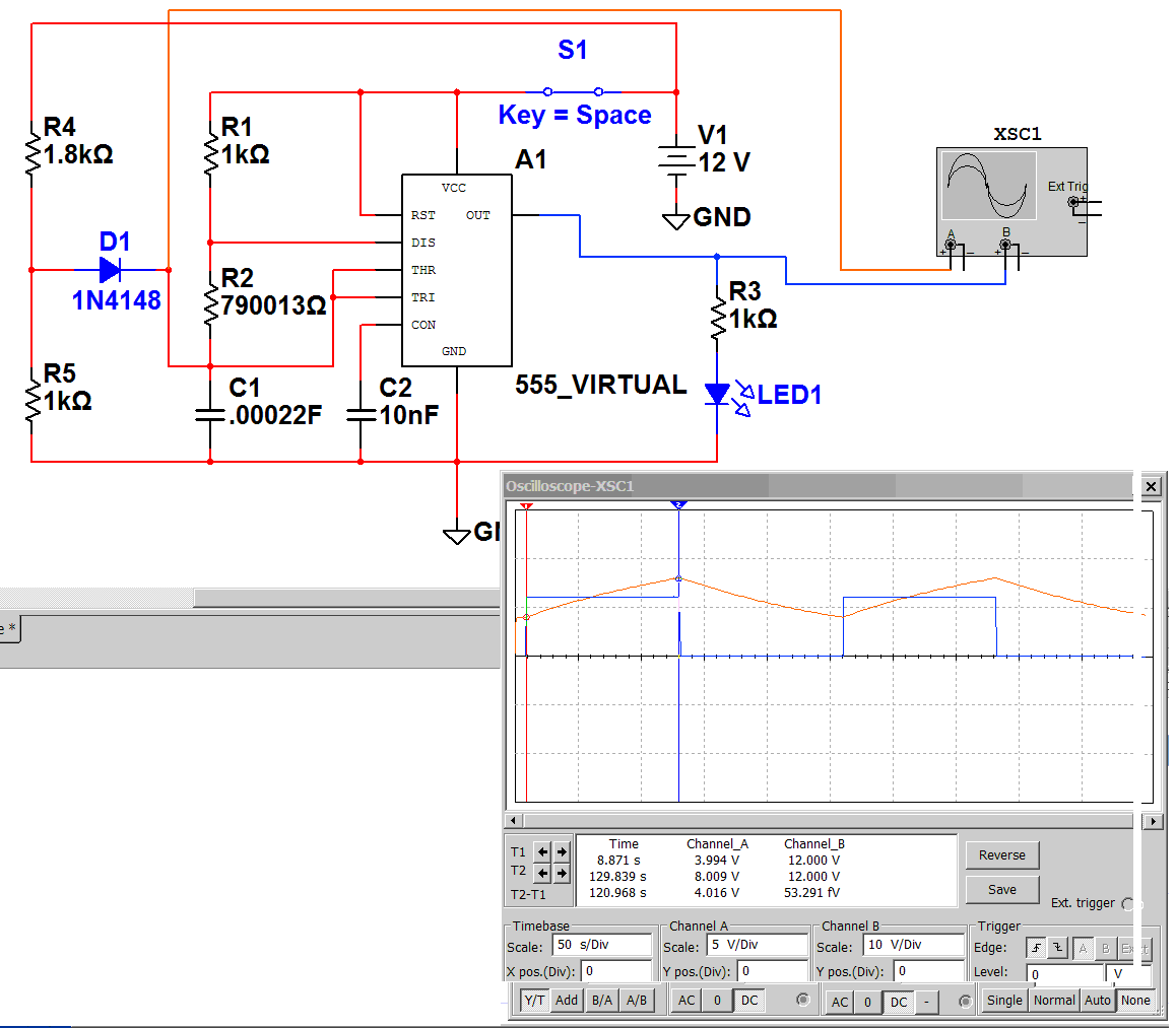

I was able to simulate the circuit correctly with a total output period of a little over 240 seconds (see below) but it takes a very long time. You can speed it up somewhat by clicking the "Simulate" tab, selecting "Interactive Simulation Settings" and setting "Initial Time Step" to 1.0.

yea the period is around 240 but the first high time is around 190 seconds and it takes two cycles or so for it to get close to a 2 minute high and low time, but its fine i will just get it to the point it works and pause it and then show my teacher because he knows multisim doesnt work right. Also i did know about using the suffixes with the resistor and capacitor values i was just typing it in off my calculator, but you are right my teacher would get on to me if he saw that so i will definitly try to get in the habit of doing that. Again thank you all for the responses.
The first time high of 190 seconds will likely occur in the actual circuit as shown in the simulation. That's how long it takes for the initial charge-up of the capacitor.

ok i did not know that i thought multisim didnt work right because it was supposed to be 2 minutes high and low and i didnt think there would be an initial charge time so i thought it wasnt working right but i guess not. how would i be able to make it so that it would be 2 minutes high and low or at most 10 seconds off.

If you monitor the voltage at C5 (C1 on my schematic) you will see the problem. The capacitor voltage starts at zero, goes to about 8V and then discharges to about 4V. The normal oscillation occurs between 4V and 8V on the capacitor.
To avoid the initial long pulse you can precharge the cap to 4V before you close S1 to start the oscillations with a resistor network and diode as shown below.

ok i see now thank you for helping. i didnt realize that about the oscillation i need to look more into how the 555 timer works.
