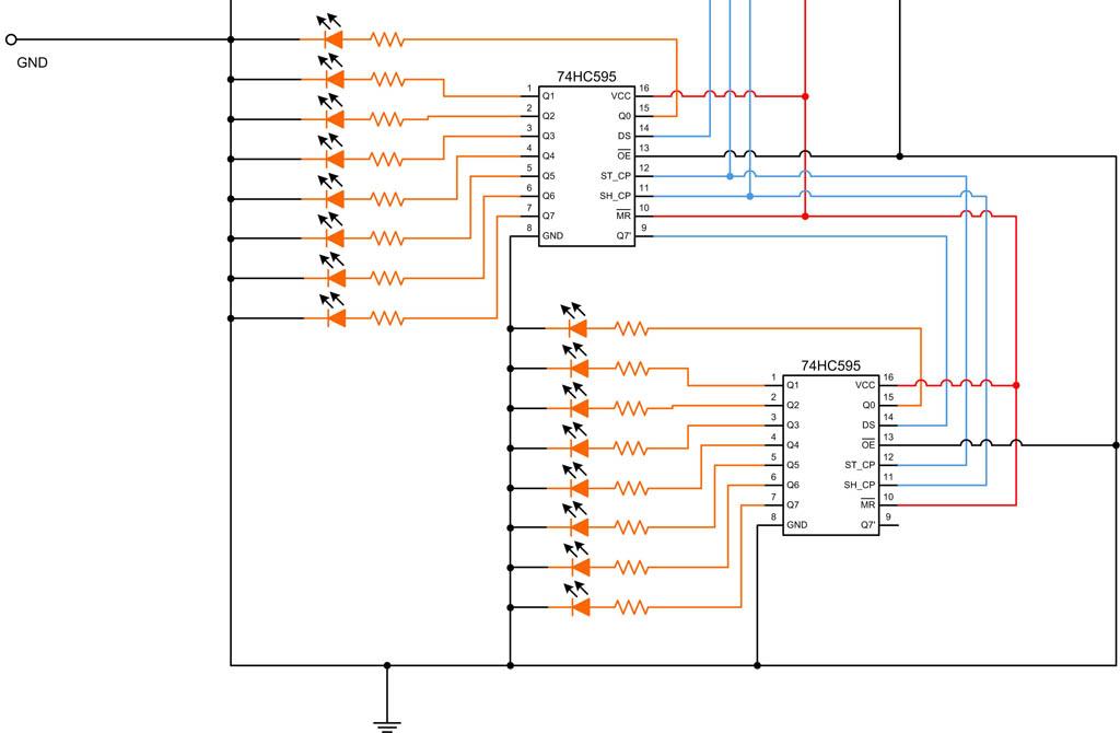

I use two 74hc595 shift registers to drive 6 - 7 segment displays (common cathode) using the multiplexing technick. The first drives the anodes of the seven segment displays and the second drives the cathodes. I ve done it succcesfully but i faced the following problem. I dedicate RA1 pin of my 16f628 for producing the clock pulses but when i shared it to both the s/r one of them did not function properly so to resolve it i used an extra pin and a second clock sending exactly the same pulses to the second s/r. It seemed that i got a noise problem or something and havent yet found a solution apart from using an extra pin. Any ideas how to share the same clock to both the shift registers?

Why not just use the two '595's in a standard daisy chain configuration? You have just one data, clock, and latch line. Be sure to clock out 16 bits each time, and pad with zeros where necessary.

Here you some thing to start with

Thanks guys for the info but my circuit is already working and succesfully driving 6 x 7 seg displays...meaninig 42 leds. :)
The thing with the clock was noise as i suspected, but i altered the topology to daisy chain as nickelflippr proposed so i saved two more pins from my pic (SH_CP and Data for the second 595). Now i send 16bit data from one pin instead of 8bits data from two pins. So my project finally uses 3 pins from the 16F628 and drives 42 leds but can go up to 64.
