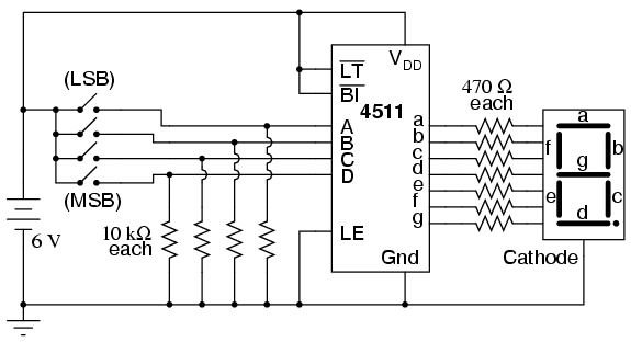

hiii folks....this is my first robot that i am making and i need help with the display...id be needin two 7 segment displays multiplexed and then increment them..the problem i am facing is with gettin 10 on the leds....please someoone help me out

okay...my project is to detect black squares which are placed all over the maze..now when my sensor detects the recquired square it has it show that on a led and so on...so for more than 9 mines im lost
fine..this is my plan i am using an at89c51 for my project and i want to take the least no of ports for the display so i am thinking of using a 4511 for the display and multiplex them to save more ppins for other uses
if u are using a pic then conect bouth severn segments to the same severn pins then conect two more pins to the comen conections e.g coman cathode . the swich the first one to low and display the first part of the number then swich the outher low and do the second part of the number
like this but with two
you cold use the 4511 to save more pins just use 4 mcu pins to controle the 4511 and then conect the 4511 where the 7 pins are

The 4511 will work, you can mux em and use only 5 output pins or not muxed will require 8.
yeah.... but i want the schematic for that....and the schematic that i am using is
This is a version of your circuit.
Do you follow it OK?
EDIT: you may find the 2 EL lines easier for your program.
