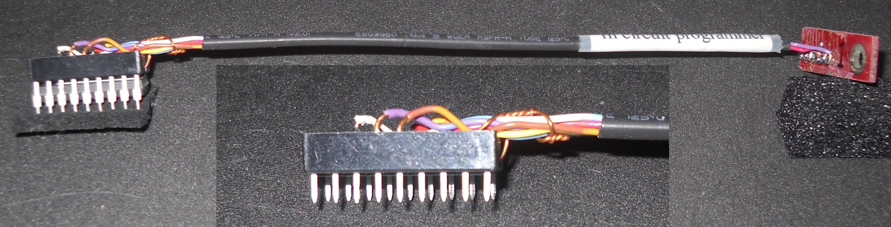

I have used this IC socket as a piggyback in circuit programmer.
