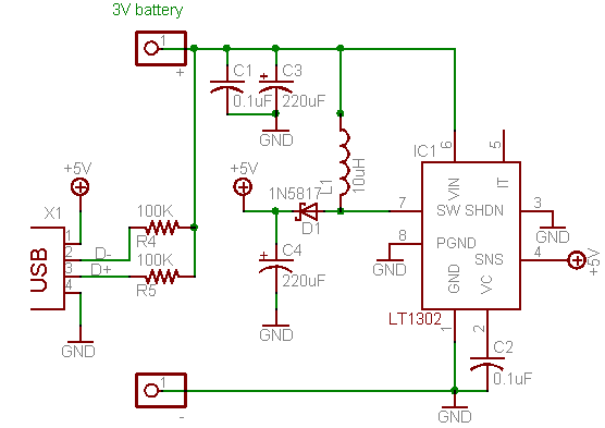

You can probably use the Minty Boost PCB attached to more batteries. It uses a versatile boost converter circuit based on Linear Technology's LT1302. You may need to change the inductor to a higher value. Consult the data sheet. I also think it would be better to develop the voltages for USB pins 2 & 3 with resistor voltage dividers from the 5V output instead of just a single resistor pullup to the variable input voltage.

He doesn't necesarily need a boost converter if he has all of those batteries at his disposal. If anything I would sugest a buck converter to cut the voltage but increase the current. He'll get more life out of 1 battery. I would like to know if he has any recargeable batteries lying around anywhere.
If he used a buck/boost converter with enough input voltage latitude he could wring every last electron out of his used "dead" batteries. :D
I was thinking he could use an LDR to regulate a higher voltage but a converter would be even better. Especialy one similar to the one you post it. But he never said that the batteries were dead so a boost converter may not be necesary. If he used a buck converter it would drop the voltage but increase the current and the life of the batteries he's using. Even though the phone only needs 500mA to charge. If he uses a voltage monitor then he can watch the battery voltage and shut off the converter before it drops below it's effective opperating voltage.

Hi thanks all for your answers.
I'm not good at electronics because I didnt get a thing about what you said.
Basicly, the above schematics could work replacing 3V batteries with 4*1.2V using a different inductor ? Could you tell me which value then?
"I also think it would be better to develop the voltages for USB pins 2 & 3 with resistor voltage dividers from the 5V output instead of just a single resistor pullup to the variable input voltage."
There you lost me 100% ! :)
First you said NiMH batteries, then "unused batteries". I took all this to mean you wanted to reuse "dead" alkaline batteries. Designing a buck or boost converter is not a beginner project. You can probably use one of the available USB chargers like the Energizer mentioned above or study some buck/boost IC datasheets to see what's involved.
