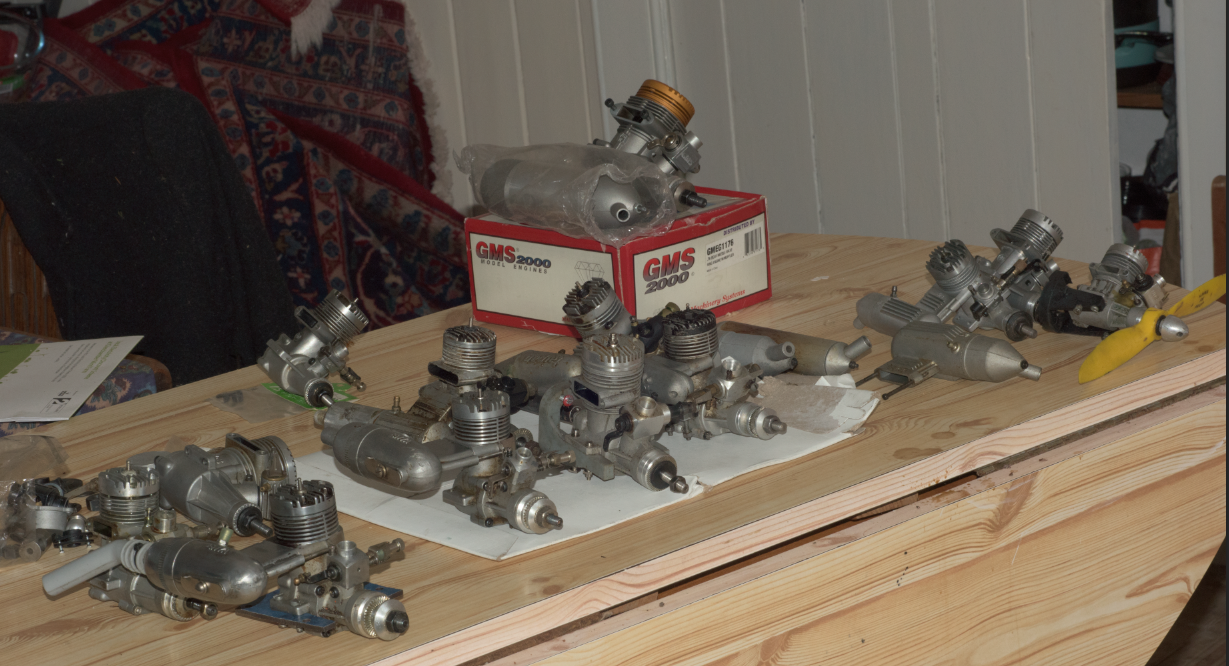

Just some engine porn! most of these are going to be sold on, I am keeping a couple to use for experiments etc but most have served there purpose and time to sell on. The two glass things are for testing glow fuel and being able to actually seen the burn, the one with the coil is platinum coated like a glow plug and the other is two platinum wires with a tiny gap in case I go the spark route, they are deside for this kind of thing and can take combustion inside.

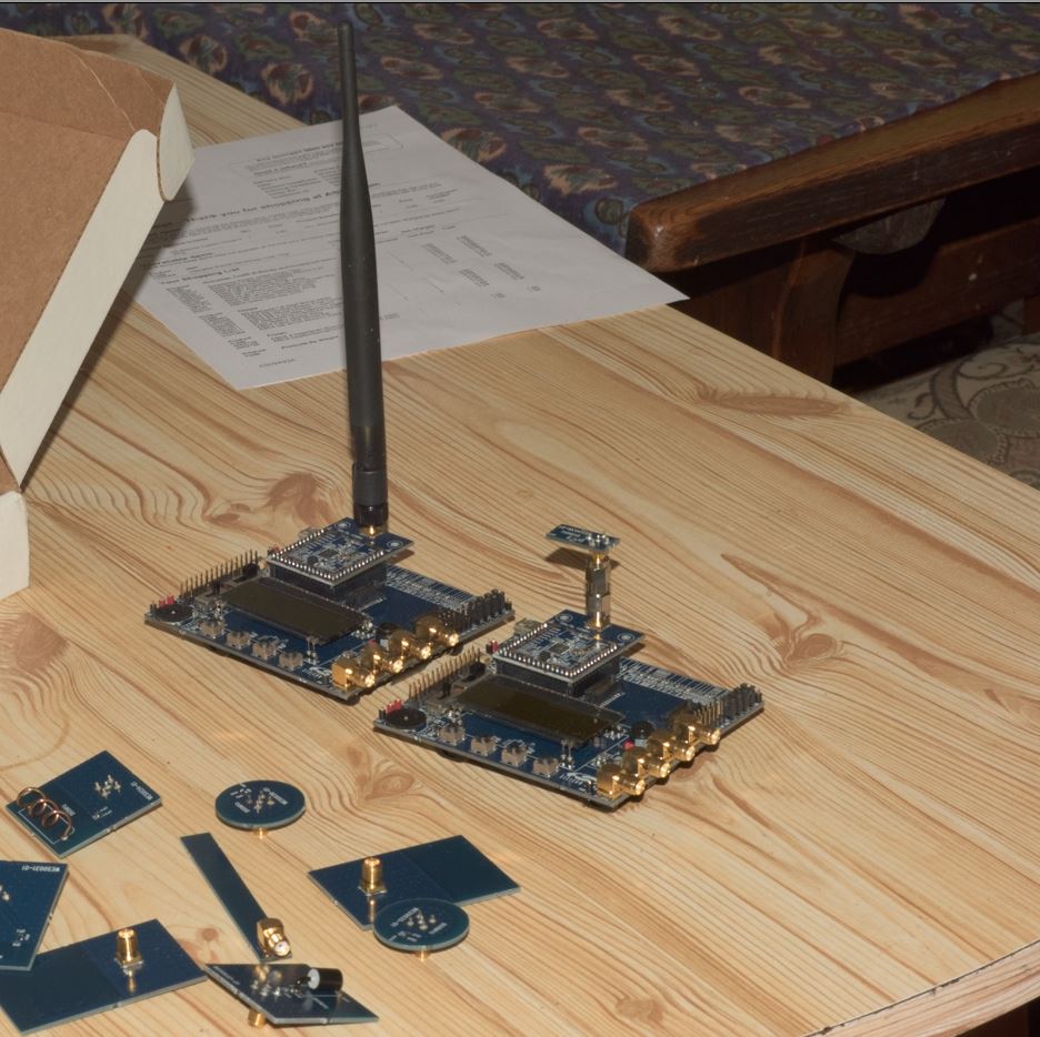

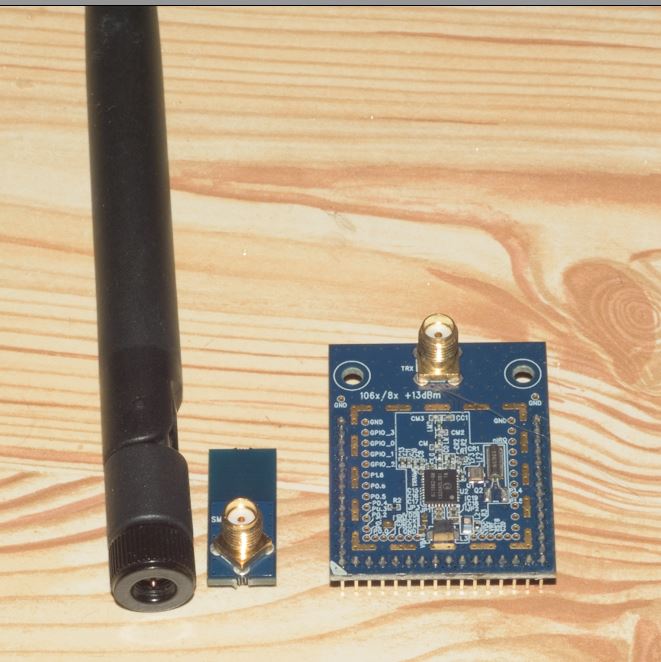

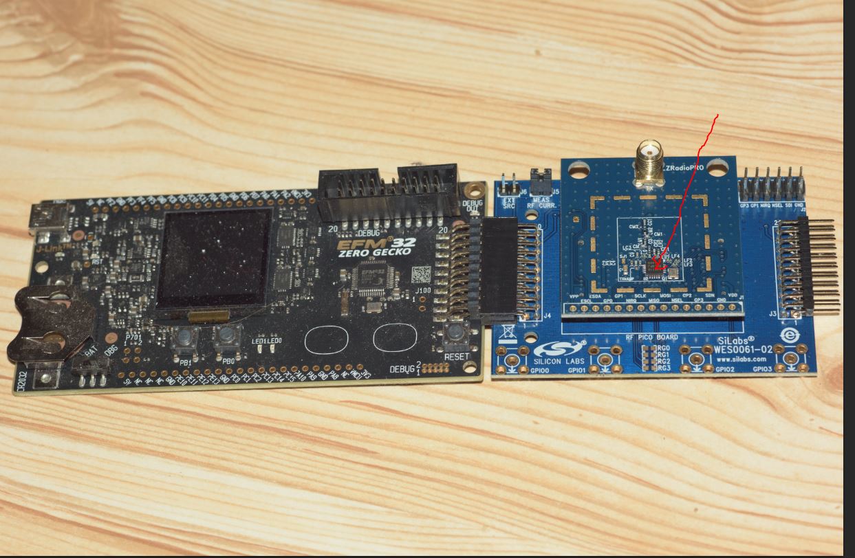

Jim I am off to bed soon, but before I go the frequency is 868MHz and the chip is the one in the pic with the red arrow pointing to it, in the morning I will post the datasheet. Trust me this chip your gonna love :D. I will be using two of them.
I am genuinely hoping the specs are gonna make you feel all warm and fuzzy inside :D, Also the UAV is actually intended to fly 99.9% of time automatically, the ground station is mainly for monitoring and will have the ability to 'interfere' if needed. But once in the ait I am hoping the ground station wont need to do much other than read the telemetry stuff being sent back, the chips are micros with built in transceivers, I cant remember the specs off hand but used them on the quad. They are really great chips
I got a slightly different version this one https://www.silabs.com/products/wireless/EZRadioPRO/Pages/Si446x.aspx it goes upto around 1mbps, but on the dev kit I have I have had it faster than that, there site isnt great for getting datasheets from, normally you use the IDE called simplicity studio, when you choose the chip in the IDE the datasheet pops up, when on the other computer in the morning I will fire it up and grab the datasheet. But the link gives you a rough idea about it
I have the updated chip with +20dbm but the pic is of the older board, I will take pics of the newer one at the weekend when I do the pics for specs. This is the datasheet for the one in the current pic (I think??) But will plug the board in tomorrow for the newer dev kit and grab the other sheet, let me know what you think of it please. I am hoping its as good as it seems to of been so far

I wasnt going to do anything about the radio side yet, but since its been mentioned I have the EZ Radio Pro set in the link as well as some dev kits that were designed for smart metering, The only difference between the two types is the one connects to dedicated dev board and the other is designed to connect there higher end 32 bit micro dev kits. on this project while messing with the radio i will be using both to get the radio side set up, I will drop a pic of the EZRP dev kit the other type of board is shown above connected to one of there micro dev kits. For the actual project I intend to just use two of the plug in boards in the photo with the antenna, they are small and light and have all you need on board.
I will get some better pics over the weekend

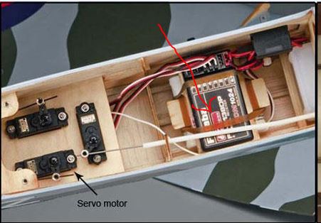

I dont understand this? we are talking about the part that normally just has the battery sitting on it, instead of being fixed it will be able to move is all. Mass wise it should be under 780g (ish) Maybe I need to find a pic on the web to show you what I have in mind, i dont think i have explained well, this is one reason i want to sort taking pictures out and getting them posted, so much easier to explain with a picture!
Ok not a great pic and not the battery! but gives you an idea, if you look at the receiver arr-owed and imagine the battery will also be in the same segment, I will mount them on a sled so they can be moved a little forward or backward to alter the planes COG
I understand that. Normally the part would be firmly anchored to the airframe and so decelerate at the same rate as the airframe when landing. The airframe would absorb the inertial energy arising from a hard landing. However, if the part is on a slide, deceleration forces acting on the slide will be transmitted through the slide driver to the airframe and that inertial energy will be absorbed partly by the mechanism that moves the slide. 780gm decelerating at several g might strip the teeth of the gears in a standard servo if used as the slide driver. Just saying.
