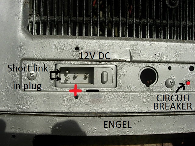

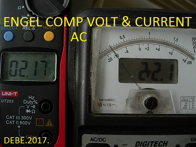

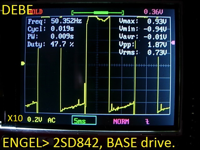

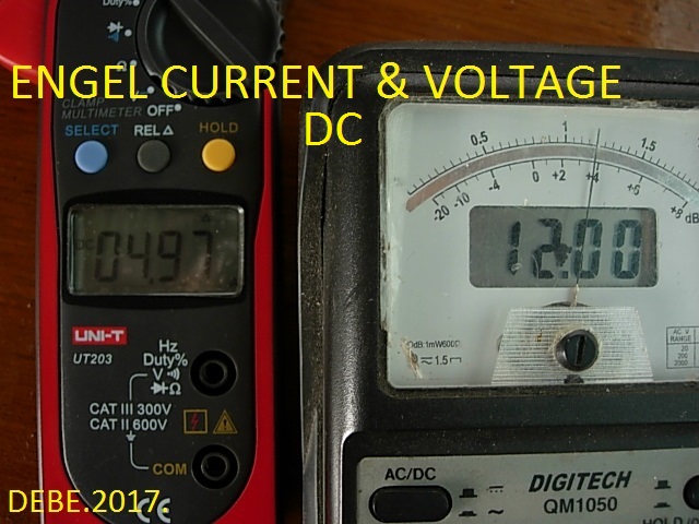

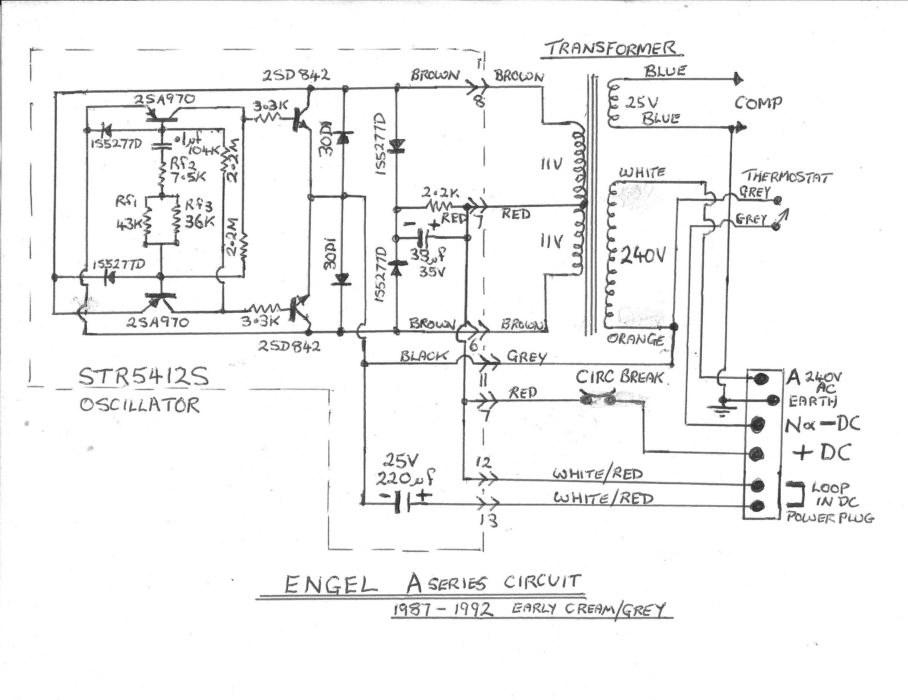

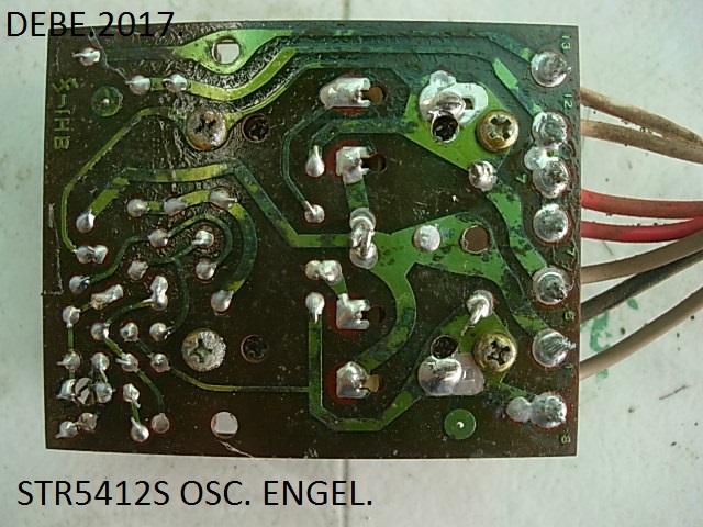

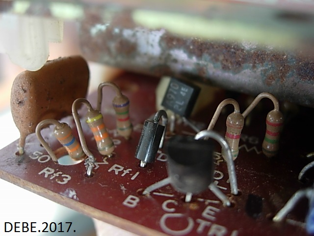

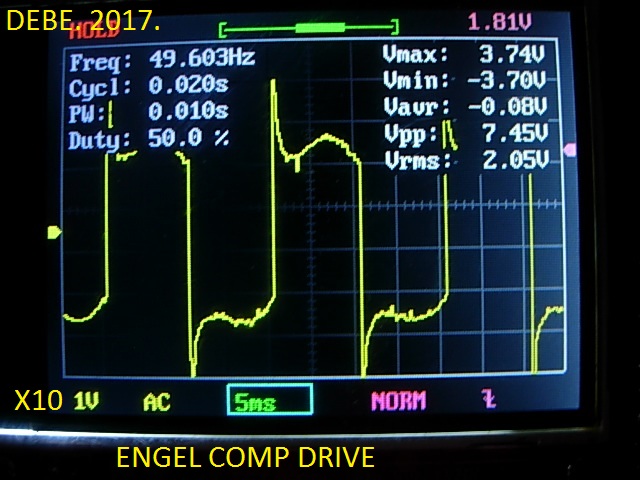

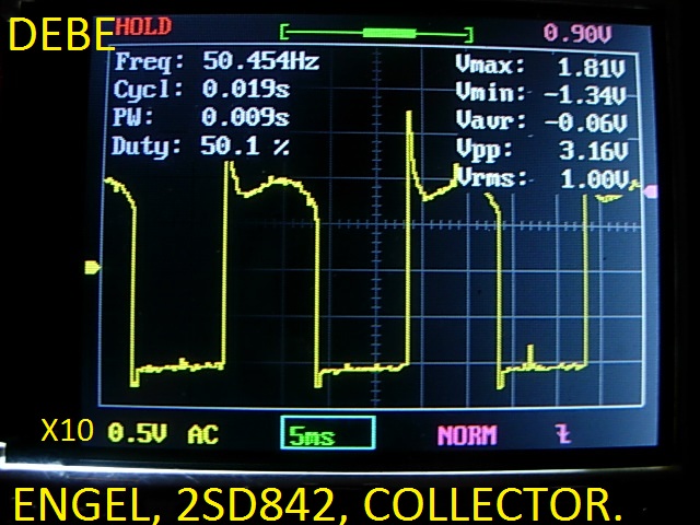

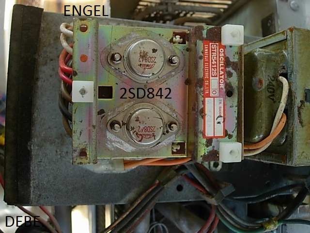

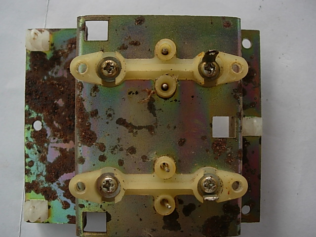

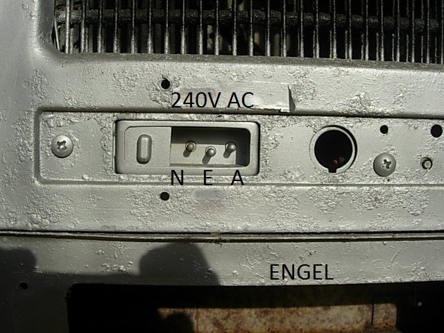

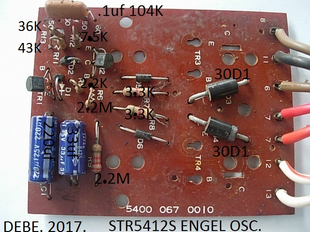

Just putting this information up for any one who comes a cross an older A series Engel fridge. As theres not mutch information on the Internet on them.
