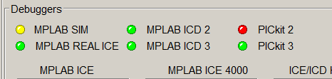

Yes, the configure menu for the 12F1840 using MPLAB 8.92 and its included MPLAB SIM shows just "yellow":
Ultimately, my question to Microchip was whether any limitations had been identified to justify the yellow. That was never answered. Yes, you can work your way to the limitations, but when you get there, the 12F1840 is not listed. The 12F683 does not show limitations, which I already knew, because it simulated fine.
I was able to get enough of an in-circuit simulation going with my hardware source of signal and ICD3 to find the problem. It was not a very adequate simulation, since I could not control the stimulus cycles.
