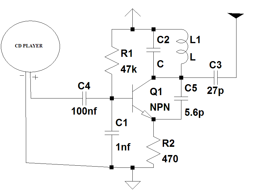

My question is this: I want to transmit a stereo signal. Can a little two transistor "bug" transmitter with the mic amp taken off, and the signal fed directly to the oscillator transmit stereo?

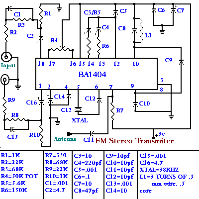

Here you go Zach.
I does not show up well on the pic ..
the inductor L1 is 3 turns of .5 mm wire on a 5 mm ferrite core.

thanx tansis, but i would very much rather use my little transmitter like on the picture here if i could. mainly because i have all the parts and its very simple. would this work or not?
No, you need a stereo encoder!.
:lol: thats wut i thought, but it was worth a shot. ill try to find a circuit on the internet that consists of components i alredy have, but if not ill try yours tansis. btw tansis, how is the range on that thing? i would like it to be powerful enough to take over other car radios sitting next to me, just for fun :wink:
With a supply of a mere three volts the broadcast range will be fairly limited , a good antenna will help but don't expect much over fifty meters.

Your simple mono FM transmitter also doesn't have pre-emphisis, the audio high frequency boost that FM radio stations use. So the FM radio will sound the same or worse than AM, like you have its treble control turned all the way down.
If the radio tunes stations by digital synthesis and the transmitter's frequency drifts (which it probably will) then the radio will reject it.
