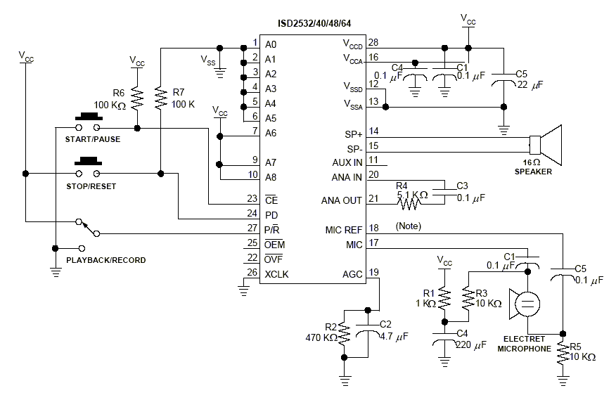

Im looking for some one to help me design a circuit for a doorbell to play a 20-30 second MP3 file of my choosing which would be stored on a cheap memory card, say like an MMC or a flash rom which could be connected to a PC USB.
This would also need to have some kind of amplification and audio player.
It has been about 20 years since I last dabbled in electronics and all the help in the world would be appreciated.
Many thanks in advance.....
There are single chip solutions to this such as the ISD2532P etc. Instead of USB, you can connect the IC to your sound cards output and record the MP3 file as you play it on the computer. You'll lose a little fidelity, but it'll be plenty good enough for a doorbell chime.
Here is a typical application circuit:

I know your requested feature can be done by a single chip solution and the unit cost for that chip is around USD 3.0. No amplifier is require and the MP3 songs can play directly from SD card...........

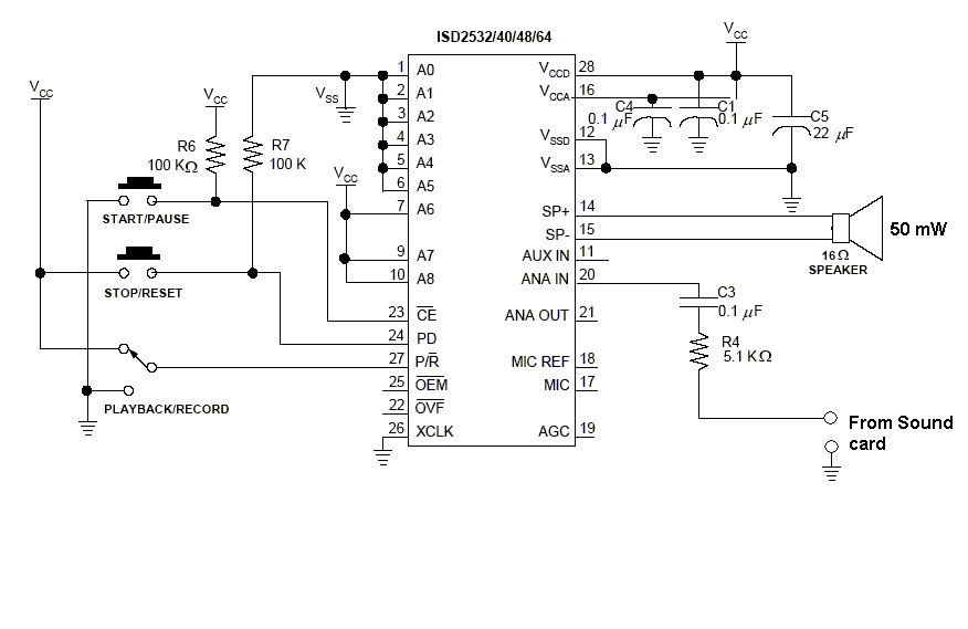

I have been looking at the posts and I am aware that there is a singal chip solution to the design of the mp3 doorbell. However, I am not very clear of, how to record the mp3 songs onto the chip (ISD2532) without using a mic.
I would try the sound cards LINE output jack to feed the ISD2532 like this:

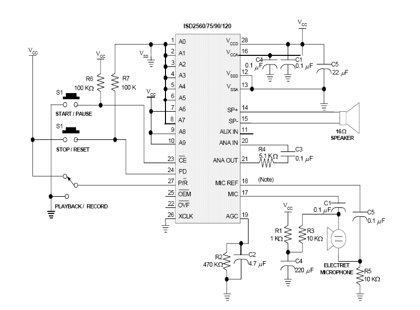

Trying to test this circuit using an ISD 2560 chip. This is the only one I could find here in Brazil. Datasheet is very similar to ISD 2532.
In following the circuit I used a mic off an old laptop computer and a 16 ohm motherboard speaker connected directly to pins 14,15.
I have only breadboard it so far... But cannot get any output on the speaker. Anybody have any ideas on how to troubleshoot.
Thanks, Marc
Is this the circuit you used for the ISD2560? Because it is different than the ISD2532:
Hello kchriste,
Yes that is the circuit I used. And the only difference between that circuit and the 2532 circuit, that I noticed, was that with the 2560 you need to tie pin 8 to ground.
I did manage to finally get it to record using the microphone. I had missed one connection on my breadboard. Sound from speaker is very faint so I guess I must incorporate an amplifier. Also will try the line input version next to record an mp3 sound from the computer.
