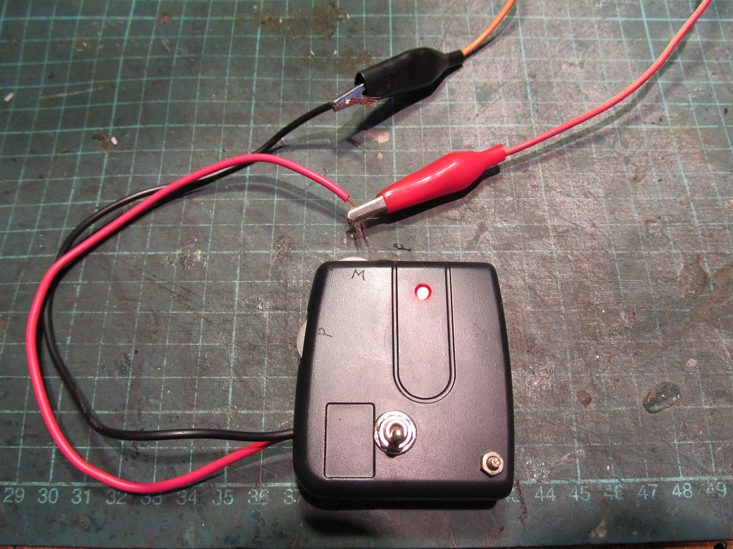

Don't be disgusted by the title, I'm not trying to attach a sub woofer to my motorcycle :hilarious:. Recently I had acquired a little helmet-to-helmet intercom (wired, powered by two 1.5v batteries) and it works great. Next natural step was integrating the intercom to the motorcycle frame, including some nice jacks for the pilot and the copilot, and of course feeding it from the motorcycle electrical system.

Having a chat with the copilot was done, now I needed some music. The intercom already has a 3.5mm AUX-IN connection so it looked trivial.

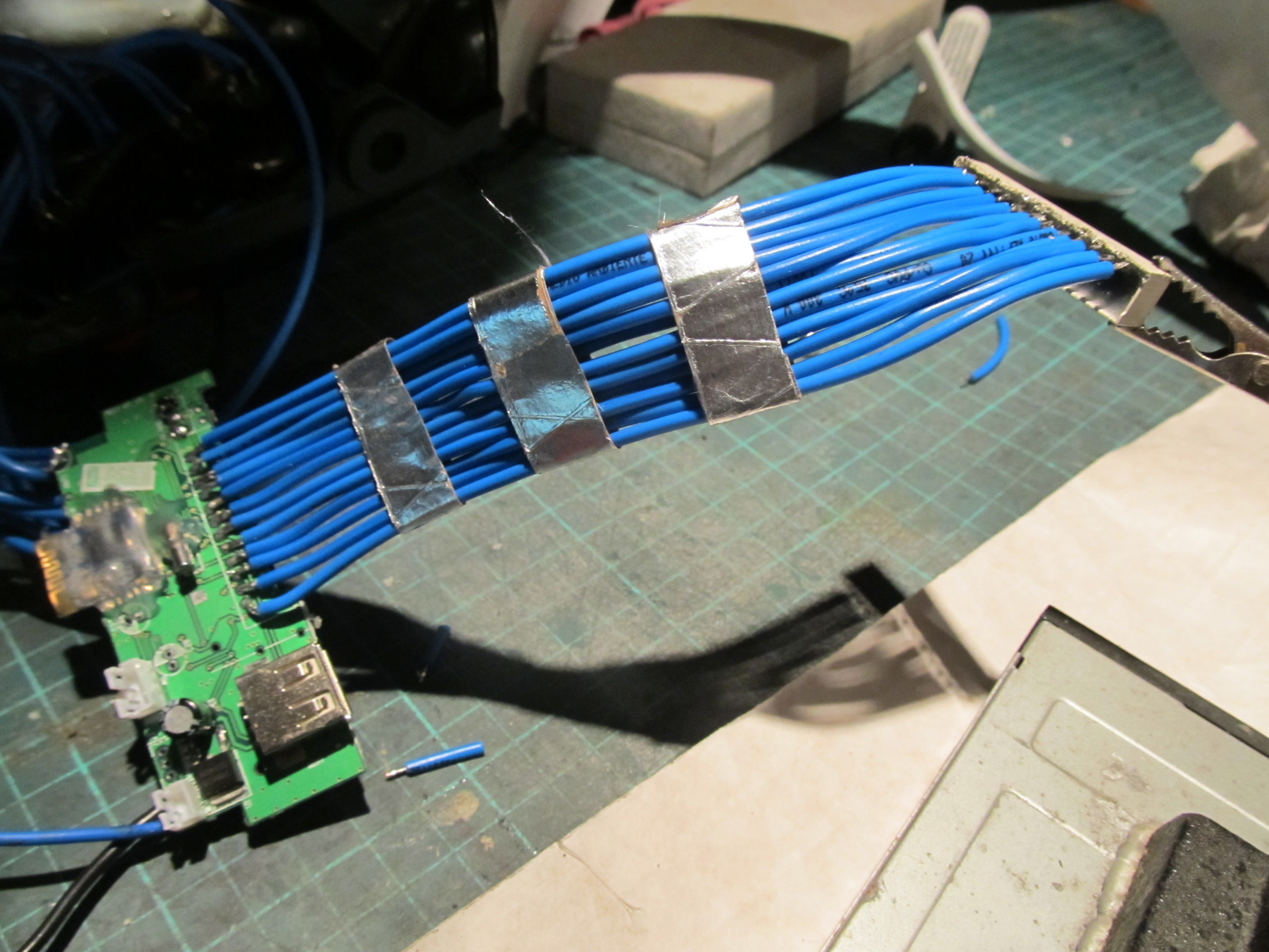

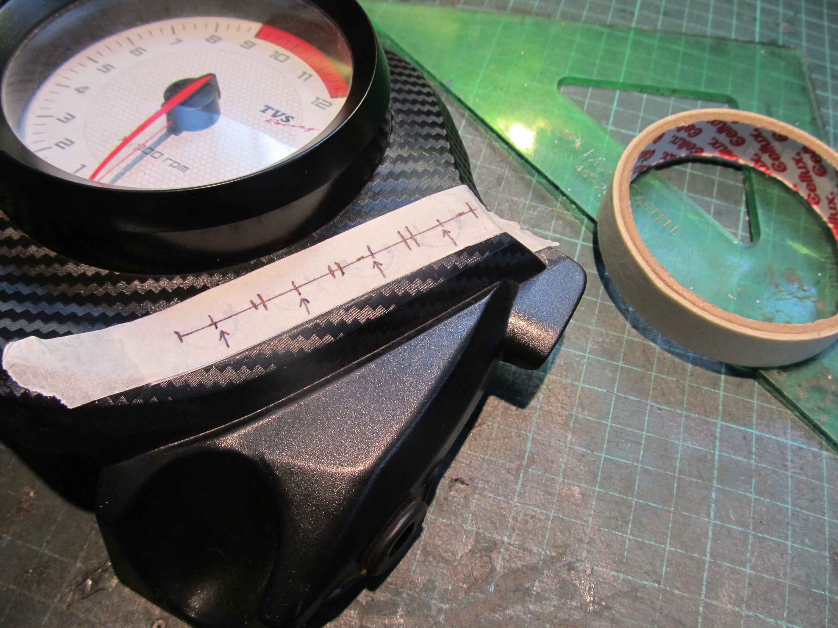

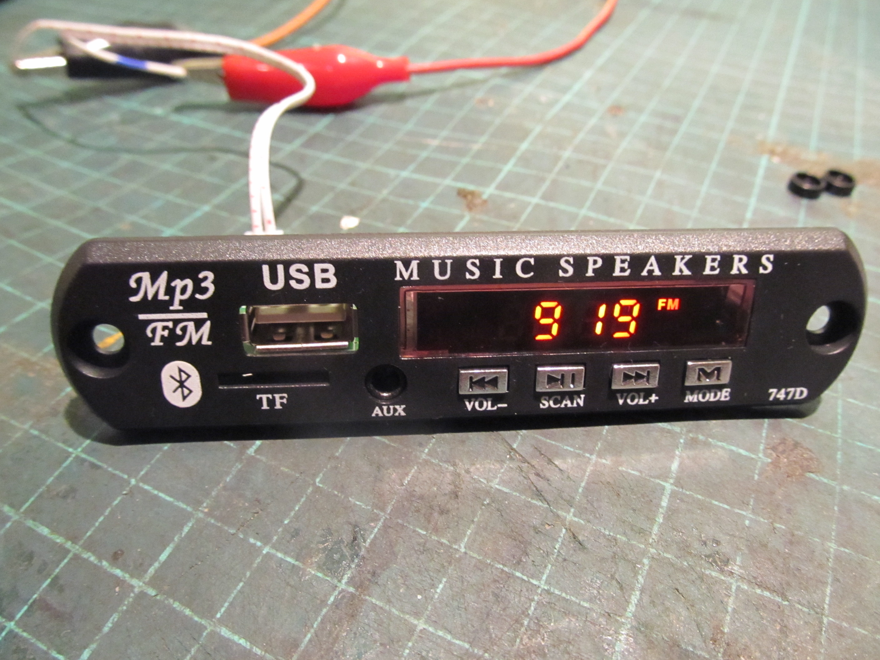

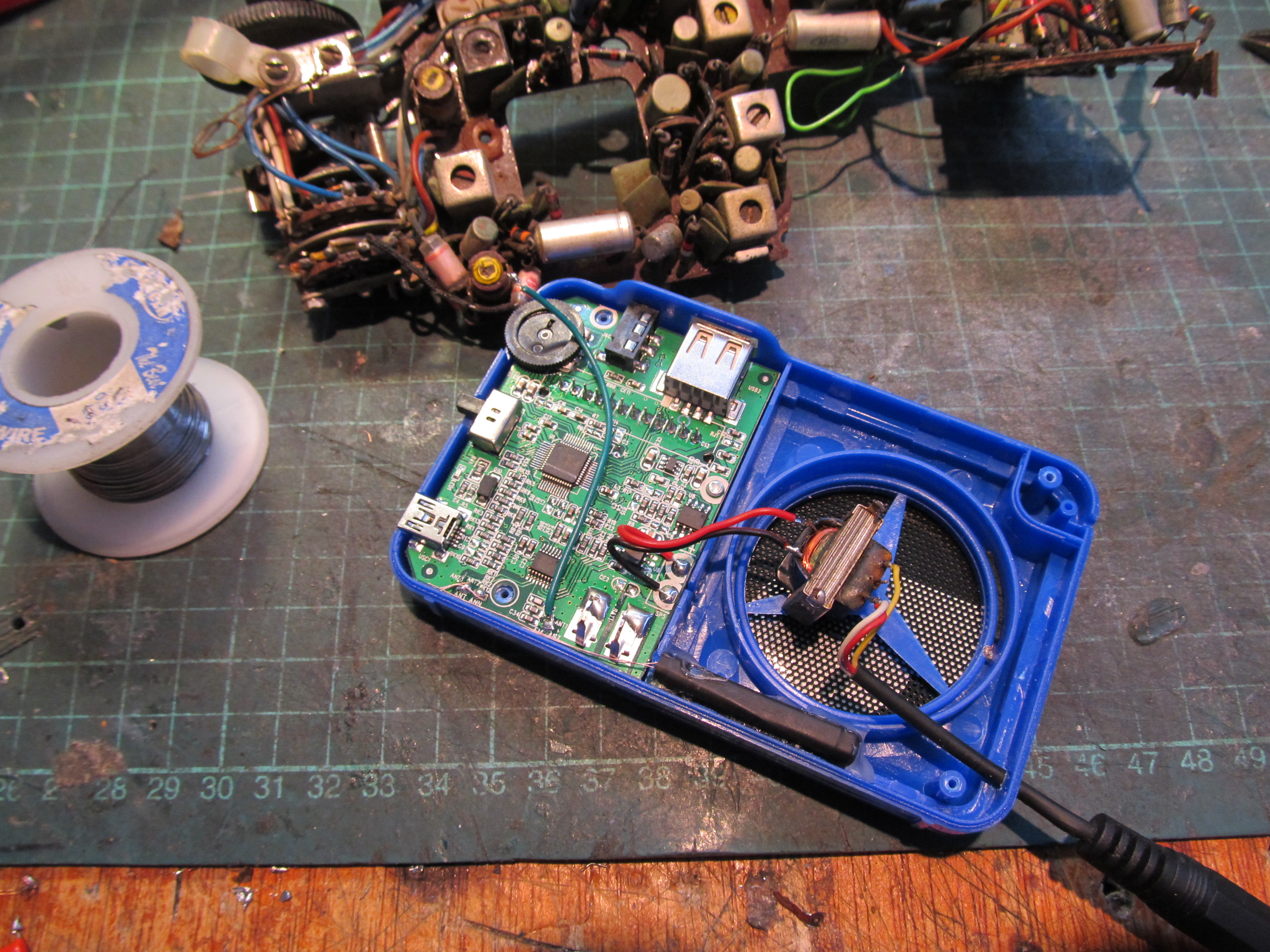

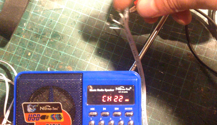

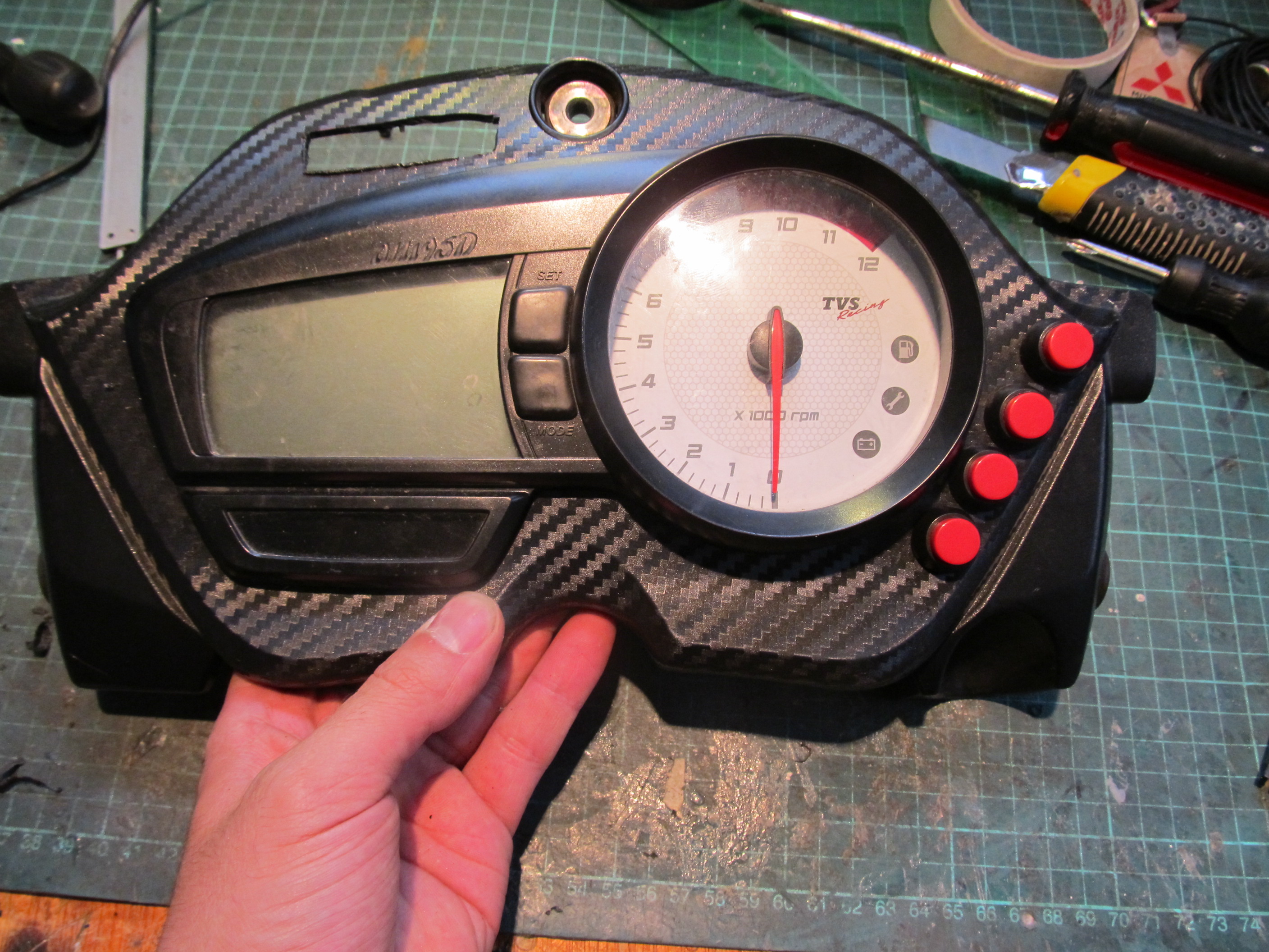

For the "head unit" I got t got one of these "chinese a mp3/fm radio/bluetooth modules. I replaced the existing surface-mount push-buttons with big external push-buttons mounted on the motorcycle dashboard. I also extended the 7 segment display connections to mount the display on the dash.
It worked nicely for a couple of weeks, but weather and electrical interference took a heavy toll on the poor module. It had the bad habit of changing tunes or volume by itself, creating a driving hazard. I didn't mourn it too much when I removed it: FM radio sensitivity was null, settings where not saved when powered off, and the user interface was very messy to use. The module ended straight into the junk parts bin.

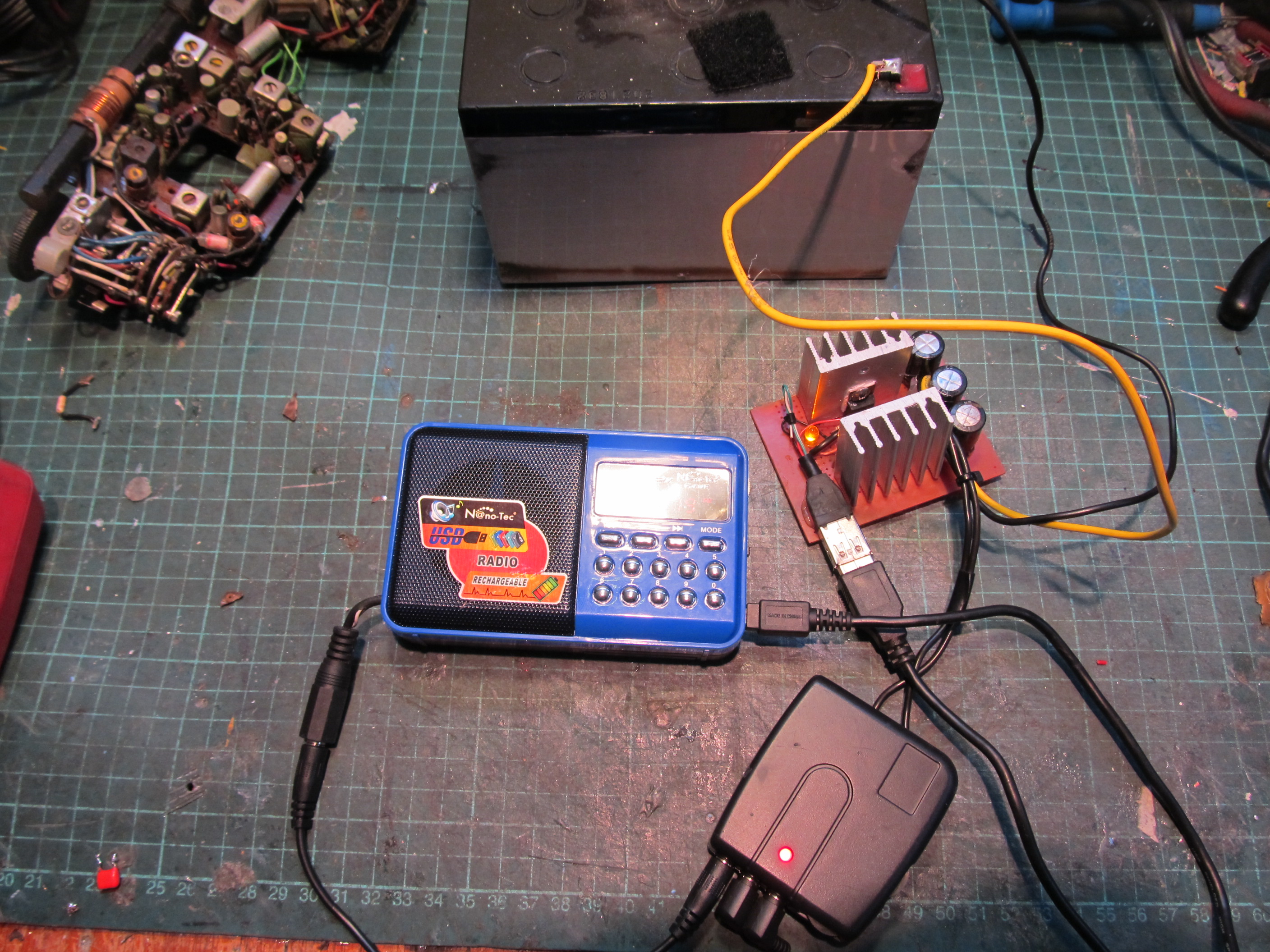

Resisting to give up, I got a new "head unit" :D. I was scared by my experience with the previous module, but I was very pleased after looking the internals of this new player. "Night vs. day", much better construction quality, and different "firmware" or code inside it. I prefer not to reveal the brand, to avoid problems with ETO.
Learning from the mistakes I placed all the system on the motorcycle back trunk, not behind the dash.

The player had no line out other than its 8 ohm speaker. Connecting the speaker output to the intercom immediately hard-rebooted the player. A small isolation transformer cannibalized from an old radio fixed this.
To control the player I did the same modification. The buttons work by shorting the IC inputs to ground, so, four buttons and one common ground.

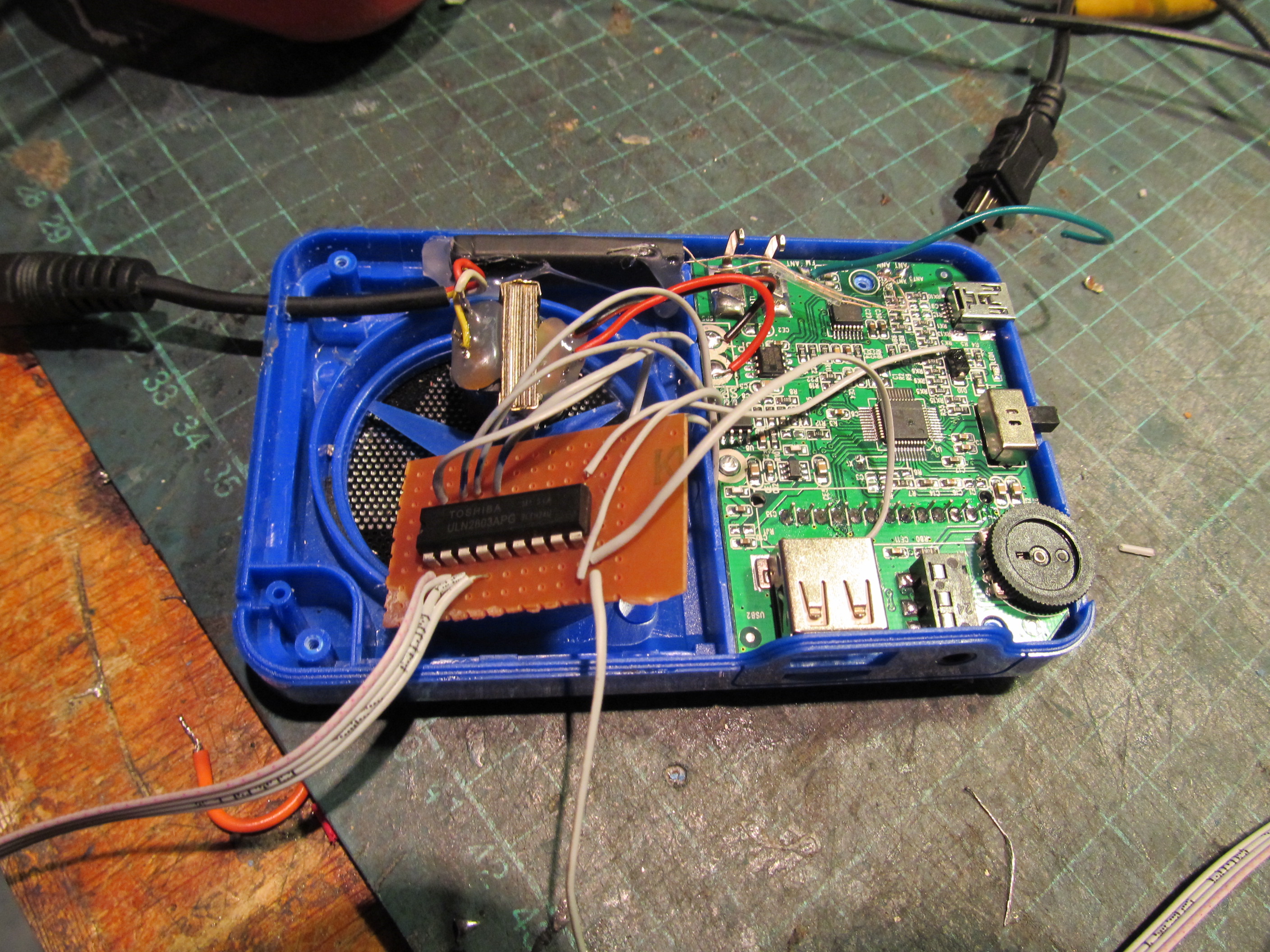

But... oh hell, I have a problem! the radio on the trunk is 2 meters away from the existing dashboard push-buttons. Naturally sending the cables all the way is no sense, given the heavy interference. I thought about sending a much higher voltage (5V) to drive 4 relays next to the player, but that would take too much space, and let's be honest, the blue case is not exactly eyecandy on a motorcycle. With 4 relays and cables, it would look like a bomb.
Tried using an ULN2803APG to short the buttons to ground at my command, but the player doesn't respond. It does, however, when I connect the cables directly to ground, bypassing the ULN IC.
So, this is it guys, I'm stuck on this part. Any input from you would be extremely valuable, since I don't wanna take the relay route.

Felipe,
It would be interesting to know if the inputs are positive or negative with respect to ground. I wondered about suggesting opto isolators but rejected the idea as they would just have an NPN transistor (The same as the ULN2803) so they would probably not work I then thought about a CMOS quad bilateral switch (CD4066) bit after seeing "KeepItSimpleStupid's" suggestion I think that is better. I have not seen opto isolators with FET outputs before.
Les.
Assuming the chip inputs have week pullups built in then you could reduce (hopefully eliminate) any noise by tying them high with a low value resistor and use a capacitor from pin to ground. Something like a 1k resistor from pin to v+ and 0.1uF from pin to GND. Might work, might not but worth a try.

Many of the buttons are multiplexed. Low power means CMOS logic levels. Not much more than 0.3 V from ground or Vcc, Even though an opto FET goes down to 200 ohms, it doesn't t have a diode drop, So, while I suspect a wide range of resisor values will work, I suspect I diode wont. If a diode won;t work, then...
The 2803 is a Darlington, so your dealing with 2 Vbe drops or two diodes in series.
I've used the Optos. They work wonders
Looking at the number of buttons I would have expected them to be multiplexed. (As a 3 x5 or 4 x 4 matrix) As shorting the buttons to ground works they cannot be multiplexed. If it was multiplexed then neither side of the buttons would be connected to ground. Also it looks like one side of the buttons is soldered to thick sections of track which is probable ground. I found out yesterday by Googling "opto fet" that there are other manufacturers of opto isolators with fet outputs. If you look at Farnell's website searching for optical fet does not give any matches but optical mosfet does.

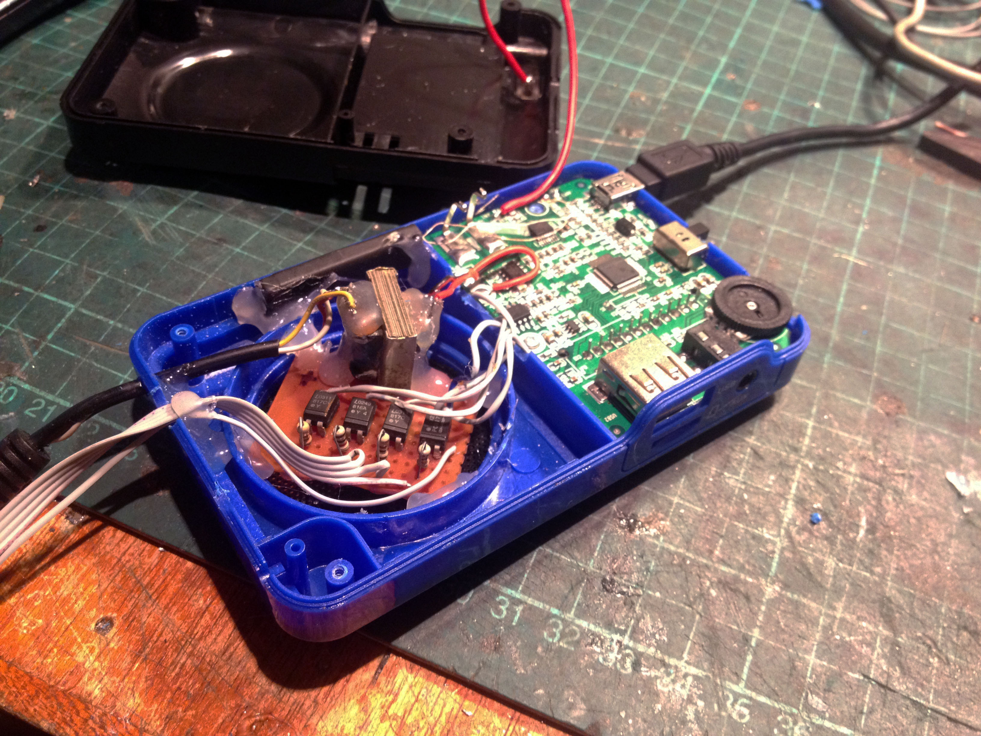

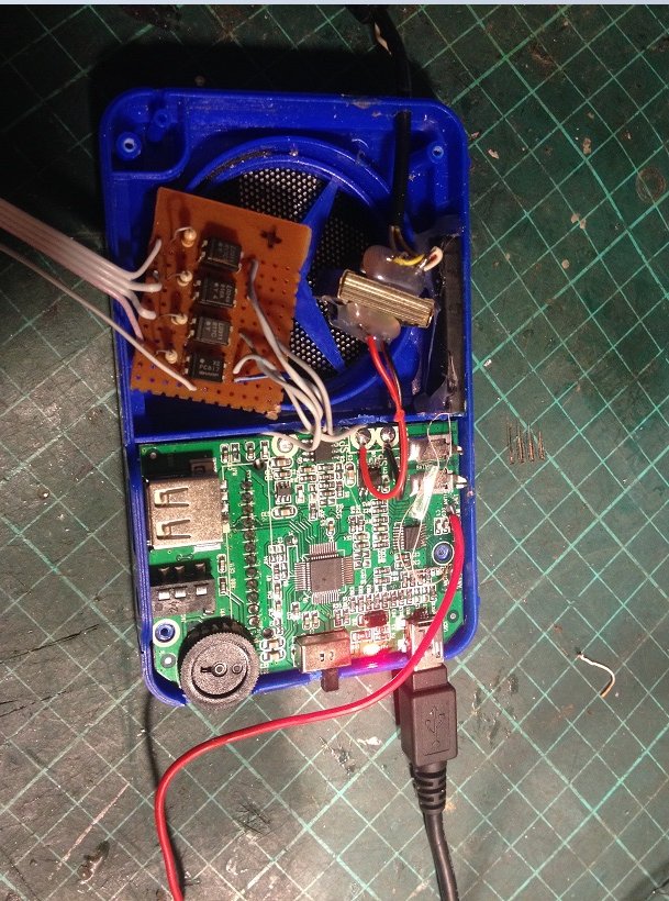

Hello again guys! I'm very happy to tell you that the project is going great, thanks to your advice.

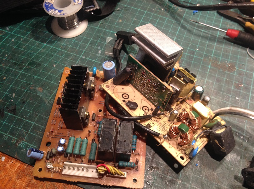

First step was finding the photo-couplers. Since I go out of work too late and all electronics shops are closed, I ended up cannibalizing a couple of burned power supplies at home.
A very old computer PSU had three Photocouplers inside it (A beautiful, heavy unit, probably hand made, with enormous heat sinks, every component wrapped on heat shrink, not like the crappy cheap PSUs you see today). I googled the label of the three PCs but could't find any datasheet.
The fourth and last PC came from another PSU, and is labelled as Sharp PC817.

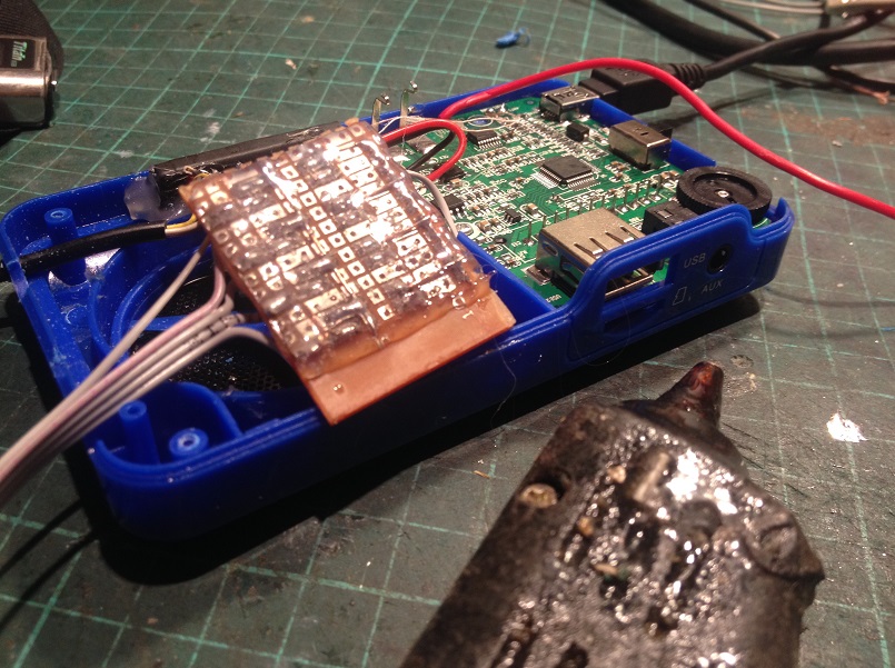

Following the Sharp PC817 datasheet:
Pin 2 and 3 went to GND
Player input went to pin 4.
+12V control signal (from the switch on the dash) go to pin 1 via a 1K resistor.
I followed the same arrangement for the obscure-brand PCs.
And it worked!!! Like a charm!!
It was time to add a big and ugly hot glue blob to avoid short circuits
And to keep the new components stationary inside the case
