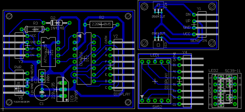

Hi Martee,
you will need the neutral switch anyway. It's built into every motorbike and prevents the starter cranking the engine if a gear is shifted.
This circuit uses two TLE4905 Hall switches to determine the movement of the shifter.
Glue a small magnet to the shift lever with the South pole facing the switches. The numeric display changes count if the gear has definitely been shifted.
The software is set to five gears, but can be changed code for a total of six in the source.
The microcontroller used is an ATtiny25.
If you are interested building the circuit PM me your email address. I will then provide the Eagle files and the source code.
The design uses two different sizes of display, one 13.2mm and the other one 10mm high.
Boncuk
