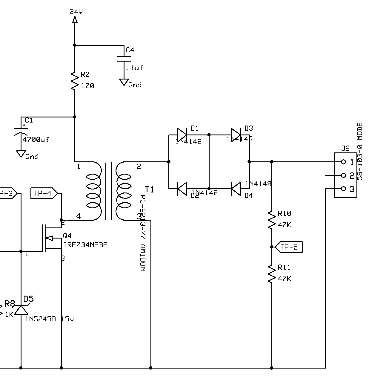

OK E,
Not sure what you mean by a burst width generator, but think I'm doing a similar thing.
My computer generated signal is ms pulses of the desired ultrasonic frequency (say 40khz).
I also use 24v. See enclosed diagram. I am working on various applications, but bio-diesel is not one of them.
Mac

hi Mac,
By burst I mean the number of cycles of 40Khz that you gate to drive the transducer.
As your 40KHz is generated by the PIC have you arranged for a method of fine tuning tuning the 40KHz source, while the power amp is running, so that the transducer is resonant?
Eric

Hi Eric,
Isn't the number of cycles (burst) of 40khz determined by the length of the ON pulse? A 20ms pulse will have more cycles that a 2ms one (10 times more).
The size of the Burst is directly related to the duty cycle. In order to increase the burst time, we need an amplifier that will take more power. Currently I can't get past a duty cycle of 1% without smoking the heatsinked Fet. EG: 5ms ON and 500mx OFF.
As I mentioned before, I dip all transducers to find their exact resonant TX frequencies and their band pass.
Then I program the CPU to change frequency over the band pass. If the BP is say 2khz wide, I will step the frequency up by 100hz every few seconds.
That way I send multiple bursts to 20 different frequency locations, of which a few should be more effective in ringing the wafer.
What do you think?
Mac
hi Mac,
If you post me details of your transformer [ winding ratios and VA rating] and the way you have the transducer connected, together with the tuning capacitor I will run a LTS simulation of the amplifier.
You should be able to get a higher duty cycle without smoking.
Eric

Fet drive level is about 8 volts. Here is my circuit:
