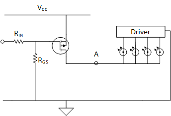

I would like to know how to setup a mosfet to take a 5V/0V (from Arduino) output and use this to switch Vcc to an LED array.
The Hi Power LED array has 4 LEDs in common anode configuration. the cathodes of the LEDs are fed into an LED driver IC.
So basically I would like to switch the string on by connecting the LED strings common anode to Vcc when the arduino IO goes high(5V) then back to ground when low(0V)
I put together this simple representation online hope it help to explain
In a word:
Logic level mosfet :)

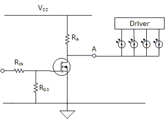

Thanks for the advice, So far I have come up with the following circuit to address my issue:
However I am not happy with the need for Ra, this implies that current for the LEDs are drawn through this resistor. also when the mosfet is "ON" current is again drawn through here.
Ideally I would like point A to be switched between Vcc and ground (or even hanging).
Also ideally I would like the 5V to the MOSFET Gate to tie A to Vcc not as present where it is reversed.
What is Vcc (Volts)?
What is the source of the signal that drives the left end of Rin?
he means For bidirectional ports , All your FETs will be turned on at the same time, when uC is reset to all inputs.
If this is not intended, Change Rgs to pullup. Right now its Rgd.
Otherwise Rgs is redundant in operation with a CMOS driver.
Your individual Driver box is now upside down as a Low Side driver to gnd.
Ensure your High Side Driver can carry all low side currents with low drop ( low RdsOn)
