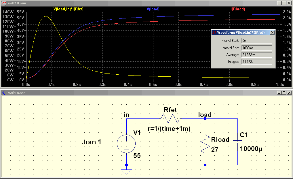

Hi guys,
I'm trying to use an IRF540 (**broken link removed**) as a sort of "soft-start" switch for particular piece of equipment with high inrush and high load capacitance properties.
So essentially I'm just ramping the voltage up 'slowly', the time scale for this I haven't bedded down. But I'm thinking around 600ms to 1500ms from 'off' to fully 'on'.
My specs are:
Vin = 55V
Inominal = 2A
With the ramp up in voltage, the current slowly ramps as well, this has potential for a lot of heat and I could blow my FET if I'm not careful and keep the junction below the max temperature.
With that timescale of ramping, how do you work out the power and heat dissipated to make sure I keep my junction at a decent temperature? Is 600ms+ ramp time even considered a transient response?
Here's a sim which might serve as a guide. The FET is modelled as a simple changing resistance, and dissipates ~10 Joules during the 1 sec ramp-up.

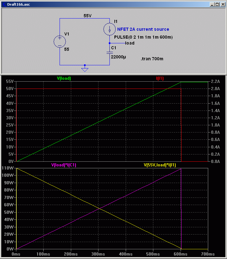

Suppose you configured your NFET as a 2A current source. A current of 2A will charge a capacitive load of 22000uF by a ΔV of 55V in 600ms.
I set up the following simple sim to show this. The upper pane shows the current into and the voltage across the capacitor. The lower pane shows the required power in the current source and the power delivered to the capacitive load during the 600ms period.
The power dissipation in the current source (which will be the same as the power dissipated in the NFET current source) is the yellow trace. It starts out at 110W, and linearly decreases to zero in 600ms.
In order to keep the junction temperature of the NFET within allowed limit, I believe that its tab will have to bolted to a thermal mass substantially bigger than itself.
That will be the problem for a future calculation...

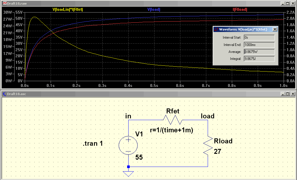

I see Mike added a hefty cap in his sim. My bad, I forgot the cap in mine; so here's a revised one :-

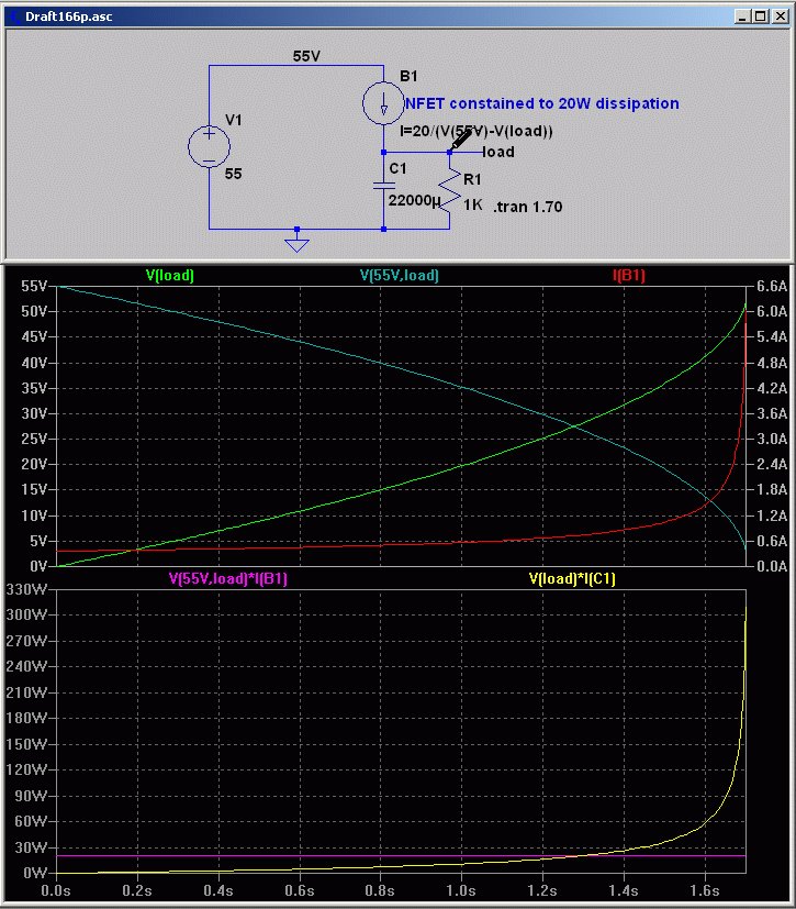

Suppose we drive the NFET in a different way: Lets come up with a control circuit that constrains the power dissipation in the NFET to be a constant, like 20W. Now you can put a heatsink on the NFET that even in the steady-state would keep the tab temperature within limits at 20W of dissipation...
I simulated this case by controlling the behavior of the current source to keep the power in it constant at 20W. The current changes as the voltage across the NFET changes in such a way such that the product always = 20W.
Obviously, it is going to take longer to charge the capacitive load if the peak power is reduced from 110W to a steady 20W, keeping everything else the same.
I added the voltage across the simulated NFET (B1) as the blue trace. The product of the blue trace (Volts) * the current though B1, (red trace, Amps) gives the constant power in B1 (violet trace, W).
Note the resulting slew rate of the voltage across the load (green trace) is now non-linear. It now takes 1.7s to charge the load capacitance vs 0.7s before...
