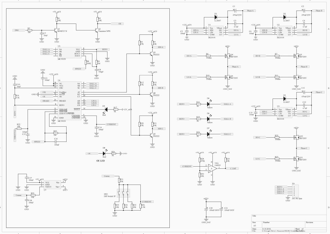

Hm, thanks. Here is the picture of schematics for this PCB

How long are your "on" pulses on the high side (at "HIN A" and "HIN B")? I presume you know that you can't keep the high-side MOSFET on indefinately because the bootstrap capacators will discharge. That is to say, each phase must start by driving low before it can drive high.
That said... if the schematic is the same as a previous version of the board that worked prefectly then there are really only two possibilities:
1) You've got a faulty or incorrect part, or
2) There is a mistake sonewhere in the new board layout and the circuit is not actually the same as the working board.
Did you assemble the board yourself, or did someone else do it? If so, is it possible that they've placed a wrong component somewhere or miss-wired the connections to the motor?

The flying capacitors (C1/C3) and those on the other FET drivers do not need to be 470uF. Is this in an application note or have you picked these values yourself? These capacitors store the charge to drive the high side FET, so they really only need to be 100x the input capacitance of the FET. if the input capacitance of the FET is, say 2nF (reasonable for a large FET) then the flying cap needs to be about 220nF. Much more than 1uF in this place could cause problems with the capacitors charging up and if the low side FET is ON for a only a short amount of time, these caps might not be charging up in time for the next high side pulse. try removing the 470uF and see what happens. Better still, remove both and fit only a 1uF in their place.
Finally, with FET drivers, you need a good decoupling cap close to the Vcc pin (to provide a low impedance path for the low side FET drive) so C5 etc has to be a ceramic cap and physically close to the Vcc and COM pin
Wow, i didnt know that those capacitors (C1,C3 etc) need to be about 100x the input capacitens of FETs. Input capacitance is 10nF so C1 should be 1uF. I replaced that caps, and removed 4.7uF from all mosfet drivers.
I tried to drive the motor and everything works like before. Motor is turning and has small amount of torque, but can be easily stopped from what point it doesnt run anymore even with throttle on full.

It's not clear to me how you've got your current sense system set up. But that is a potential problem. If it's spinning at about the right speed, but has no power, it could be starved for power. Which would happen if the current sense function was being tripped.
Time to get the o'scope out and start probing points, and looking at waveforms.
- I'd start on pin 10 of the controller to make sure that it's oscillating at the intended frequency.
- Then check the controller outputs. Use two channels, or four if you have them, to see A to B and B to C timing.
- Look at A low and A high, to learn what they're doing. Withone probe on the controller output pin, use the second probe to successively look at each link in each phase all the way out to the motor terminals.
- Look at timing between HALL A inputs, and each of A low and A high outputs. Then do the same to B and C
If' it's not running right, there's got to be a reason why, You'll just need to find where the problem is. And a two or 4 channel scope is the right tool for that job.
