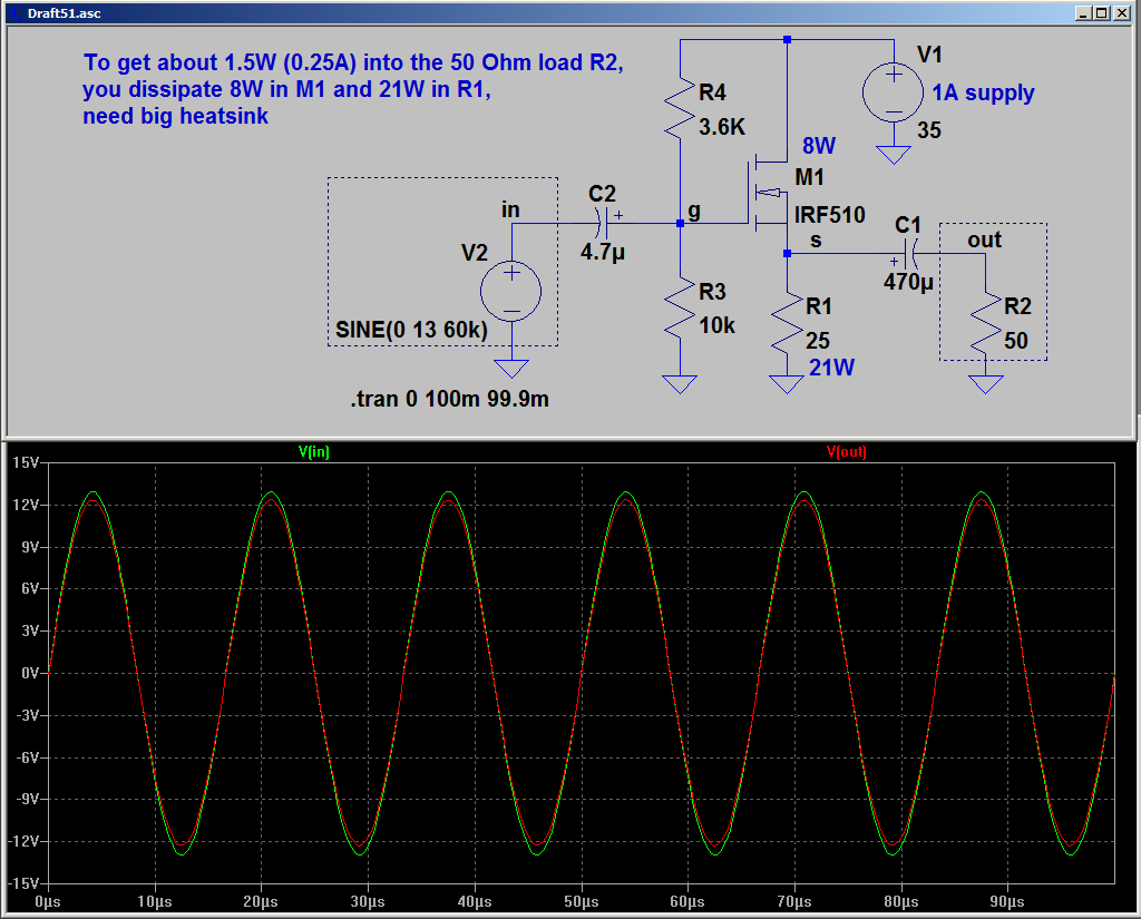

hi folks, i'm obviously being lazy here but figure i'd risk members wrath (and save killing product) rather than read through posts for a week, apologies in advance.
could someone with knowledge please tell me the simplest way (circuit) to take the signal from a signal generator and feed it into a transformer.
i want to experiment with ferrites/windings etc etc and so need to amplify/buffer the signal from the generator to the experimental transformers, which will be all sorts of inductances and all sorts of reactances.
the frequency will be below 60 khz.
equipment i have is: a 0-30 bench top psu, a gwinstek gfg-8215a signal generator, a scope and multimeters etc
i have some irf540n mosfets, so would like to use those if posssible.
i was initially at least going to keep the signals to single sided square wave.
i’ve never used mosfets and have heard they need different setup/biasing than bipolars and am scared i’ll kill the few semi’s i have before i get it right. thanking you in advance for your help.

The problem with a source-follower, even if you follow it with a huge electrolytic DC blocking capacitor, is that it will actively pull-high like mad (source current), but has very whimpy passive pull-down (current-sinking), which will manifest as severe distortion at 60kHz. You need a true power-amp, like a push-pull audio amp, which can symmetrically actively both source and sink current.
The only way to make the source-follower work is by letting it waste huge power. For example, here is what it takes to get about 1.5W (+-25V) into a 50 Ohm load using a very-inefficient source follower:
Note the dissipation in M1 and R1. We are pouring 35W in to get ~1.5W out. It is effectively a Class A Power amplifer...
With a source-follower, you are going to lose the first 2v to 3v of the signal.
