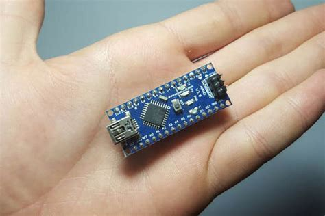

To reduce complications if you just use a NANO board and its CPU, it easily interfaces and programs
with the Arduino IDE. Just a thought. Its ~ $3. Eliminate the oddball method needed to program the
ATTINY85.

The board to use (NANO) has xtal timing accuracy, regulator :
Buy it with pins soldered in so it out of the box fits into a protoboard.
simple applications. Get a few of these to make life easy to proto (Temu, Amazon, Ebay) :

I second the Arduino. Nice and easy to get started with, tons of examples on the internet, free development Environment and designed with the beginner in mind. I got some Nano boards with USB C for ~USD0.50 see here.
The IDE can be downloaded for free so you can get going for less than 1 USD.
