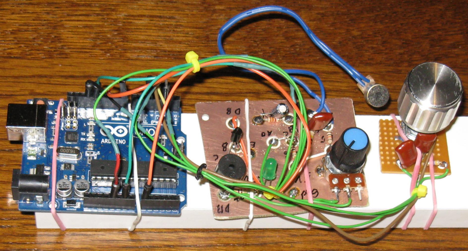

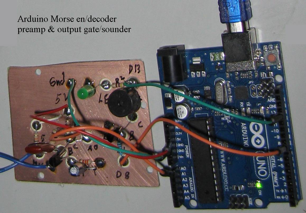

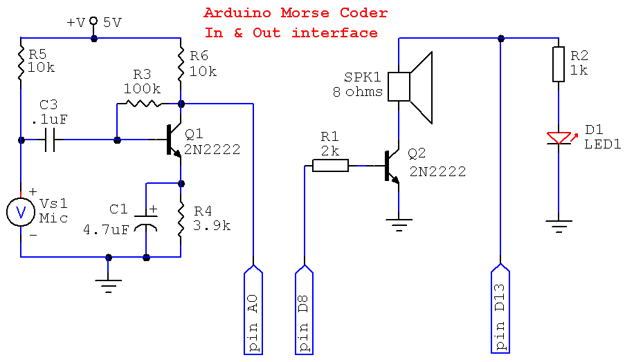

Found a sketch and adjusted it a tiny bit. Changed the mic pre amp and audio output.
Want to add a rotary encoder to set the speed (wpm). Perhaps someone will help me with that. (hint hint)
Also plan to add a backpack LCD 16x2 display. Is that a bad idea for this project?

What kind of signal you have as an input to the Arduino (pin A0)?
In the .ino file there are comments at the top that give some useful info.
More info:
https://raronoff.wordpress.com/2010/12/16/morse-endecoder/
I have not put a scope on the pre amp output but I hope it's a clean audio signal.
As I understand A0 is a kind of comparator input. It has an input threshold controlled by the software.

Thanks, B. I've made some progress.
After a little experience with the device the code I need does seem to be trivial.
I've de-bounced it with 2 0.1 caps and 2 4.7k resistors. Put the 5 components on a little board.
Edit: It seems .1uf is too high. Perhaps .01uf is better.
I say this because there was a double speak every time I moved the control. Like:
49
48
I solved the problem in software by the line
delay(1);
I now increment and decrement by 5. The decoder does not need a precise value.
Yea for that :)
This has been most helpful.

Have added a rotary encoder to adjust wpm.
Changed the parser.
Added a few features.
If anyone wants to see the revised code post here.
Have ordered ne567 tone decoder. This is needed to receive code 'off the air'.
It will follow the mic pre amp.
I would really like to add the ability to read a file or have one come in from the terminal and produce code to record. My attempt to copy & paste text to the terminal or print to the terminal or emulate typing have failed. I'm sure it's because I'm a rank amateur at programming.
I tried to add an LCD backpack but it used too much memory variable space.
If I can get a display to work a computer would not be necessary.
Hoping someone with experience will help me improve this project.
Updated version of the project. Next will be an NE567 tone decoder frontend so 'off the air' decoding should work.
As a sideline, am trying to find an automatic code speed function. Have the software find the incoming code speed.
Might have to change analogPin 0 to pulseIn pin7. Have not yet checked to see how much of a re-write that would be.
