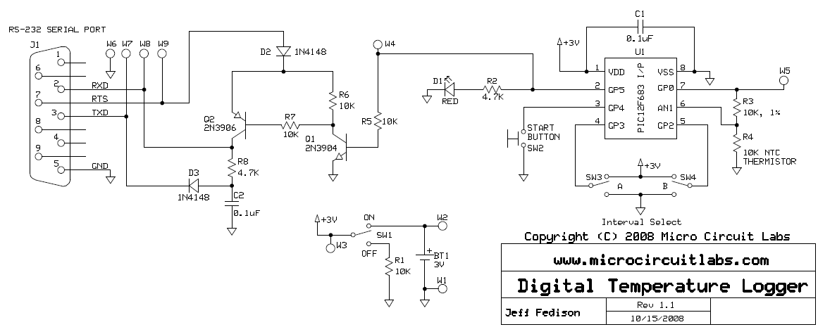

You can do all of that with one or more data loggers. There are some kit data loggers available that might accomplish what you want. However, most data loggers do not have a built in display.
For temperature monitoring, you could simply use a thermistor and monitor its resistance with a microcontroller. I will post an example of a circuit that does this.

Example of a simple 1-channel temperature data logger circuit to monitor temperature from -40 to +214F.
