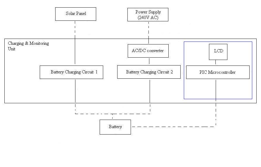

I'm not sure if I'm allow to post this...I'm currently working on a project regarding the Miniature Remote Controlled Solar Car and this is my second post. First was the DC/DC Converter (Miniature Remote Controlled Solar Car). Hope this post is allowed.
Hi there. I'm currently working on this project and needs help badly. At this point, I will be working on the implementation of the PIC Microcontroller to monitor a few matters and display them using a LCD (Figure Project). These includes the following:
a.) Read current load current drawn from the load, which is a 12V DC motor.
b.) Present the approximate life-time of the battery at that level with that drawn current.
c.) Present the battery level in terms of percentage.
:?: Would like to ask, how do I tap the current drawn by the load and feed it to a Current-to-Voltage Converter before applying it to the PIC microcontroller? :oops: At which point shall I tap the current point from? Advice needed.

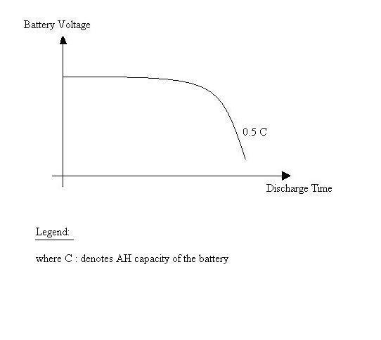

For best accuracy I would suggest you plot a number of discharge curves for different loads, and implement them as a number of lookup tables in the PIC - you can measure the present load current, and battery voltage, then call the table that most closely matches the current.
:) Is this what you mean? :oops:
I should use different loads, such as:
a.) 100 ohm resistor
b.) 1 kohm resistor
c.) 10 kohm resistor
Then, using each of these loads and leave it connected to the battery for a period of time, say 5 minutes and jot down the readings for the voltage as it varies with time. From there, I plot the graph with the following axis (Figure: discharge curve)
Then, when I apply the real load, say, a motor that draws 0.6A, I will call the table that draws 0.5C (0.65A) since it is the closest? Please correct me if I'm wrong :cry:

Yes, that's right - you need to select your tables carefully, if you do a wide range of different load tests you can then work out how many different tables you will need for acceptable accuracy.
Rather than do it manually it would be easier if you have a data logger, or multi-meters with RS232 interfaces - but manually is fine, it just takes more effort.

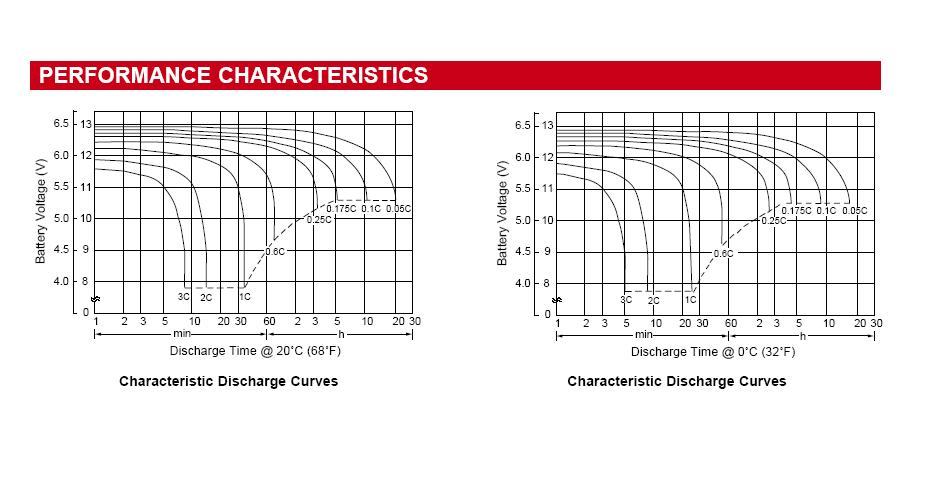

The voltage at various states of charge is well known and easy to find on the internet, EXCEPT that it's strongly temp dependent.
I found the following from the Power-Sonic website.
But the temperature surroundings in my country is around 30-34 degree celcius. Range difference from 20 to 30 degree celcius, will this range of changes cause a lot of changes in the battery characteristic or it is minor and I can implement this graph as a guide for me? Any opinions? Please?
