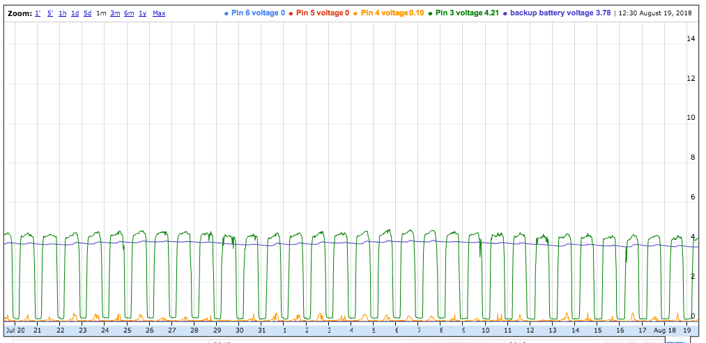

This is what I have collected running a solar-powered GPRS module. It is measuring the voltage of the Li-Ion battery, (blue) the solar cell voltage (green) and the charging current (orange).
The data is sent every half hour to a MYSQL database, and the web page that displays it uses another script puts it into a graph. Sending data to the server used less than £1 of credit from the PAYG SIM this year.
