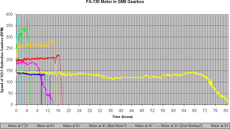

Okay, I'll see. More than 3V really does shorten the life, though:
https://www.pololu.com/picture/0J501.895.gif
