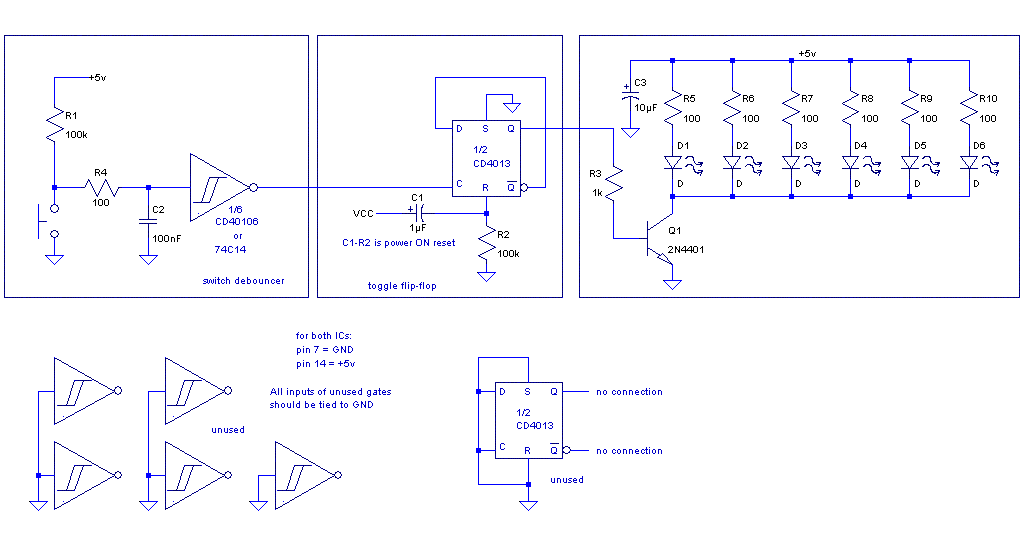

How much current do your lights draw? This is important!

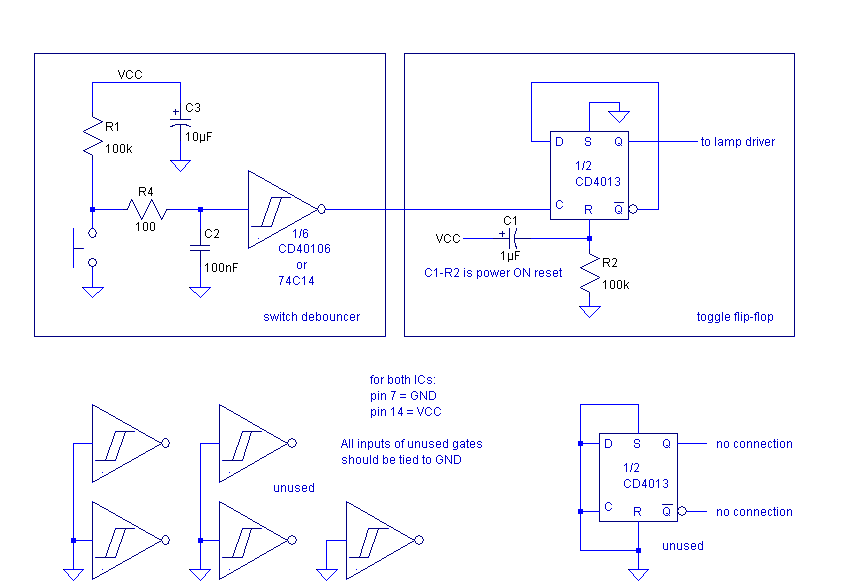

Here's a schematic. Before we can design a driver for your lights, we have to know how much current they draw, and how you want them connected (parallel, series, independent, etc.).

mixos said:
Those circuits might not work reliably with some switches and/or some brands of 4013s.
The potential problem with the first schematic is that switch bounce may cause the flip-flop to toggle more than once when the button is pushed, and possibly again when it is released.
The potential problem with the second one is that some (Fairchild), if not all, have a maximum clock rise and fall time spec of from 5 usec to 15 usec depending on supply voltage. The RC filter has a time constant of 10 milliseconds. This doesn't mean that it won't work, but it means that it might not.
My design addresses both these potential problems at the expense of an extra IC.

I have 2 lighting circuits both identical. I have 6 led's connected in parallel and a 15 ohm resistor running off 5v supply.

I've added a driver for your LEDs based on your input. Paralleling LEDs to a single current limiting resistor will result in unequal brightness if they are not well matched. I have shown a separate resistor for each LED, which will potentially give you better intensity matching. The rectangles just delineate the various circuit functions.
