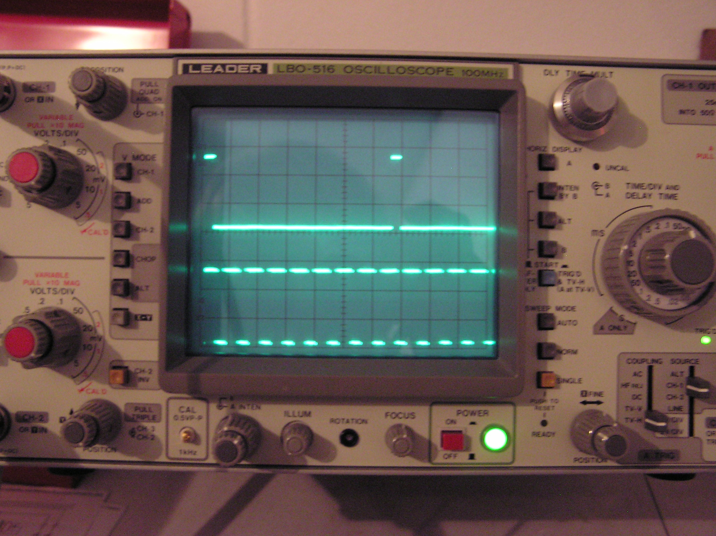

I just finished building this exact circuit. Just had to
adjust the 556 receiver frequency with the 10K pot and it
works as advertised.
I used a TSOP4838 38KHZ ir reciever and a TSAL6200 High
Output IR LED.
There is a scope picture attached.
Hope this helps.
jerryd

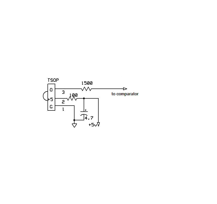

The ckt posted on reply #2 when wired according on that schematic don't work for me...i have to modify the first oscillator by changing C1 to 0.33uF, R1 to 220R and 33K but still not satisfied...
BTW see attached image for my sensor connection...
BR
What do you expect the output of the sensor to be?
Heal the world by MJ? :D
seriously a LOW for about 500ms...actually it doesn't drop to LOW as in 0 or GND level...but just a slight dip from the 5vdc output...since my sensor is active LOW...pointing a remote controller on it it drops to 3.85 VDC or lower depending on range and its perfect for my application...
There's something badly wrong there - I've used a LOT of different IR IC's and they drop to approaching zero volts - how are you measuring it?.
My IR receiver when wired like this and I'll point a TV remote control directly the 5VDC output will NEVER drop to ZERO or GROUND the lowest I can get is about 2VDC which is enough for my needs...
Now this circuit with slight modification works ok now...I just change R1 to 220R, R2 to 33K and C1 to 0.47uF..and I got about 2ft sensitivity..

The reason I keep asking what you expect is because I don't think the sensors work the way you think they do. If you use the transmitter posted the output of the sensor will be a stream of pulses having about a 500 usec. period. If you point a remote at it you will get about 8 pulses then you must push the button again.
Exactly...my sensor will respond to 38khz modulated IR that are pulse NOT continuous since sending a continuous 38khz signal will shut it down....:D
I think what he's trying to do, is avoid the automatic gain control (AGC), some receiver modules use. When there is a steady carrier being received, the module drops it sensitivity some, to reduce noise, which would also reduce range. The transmitter needs to be cut off periodically to maintain maximum range.
exactly! and I found out that a 75uS pulse of 38khz IR works perfectly....:D
