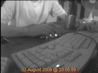

Like many night owls on the web I found that using a webcam after dark involved grabbing every desk lamp I could find to hand and burning my retinas.These days I use a Phillips CCD camera connected to the PC using a TV tuner card (its got a spare input for composite video). The camera came from a local pawnbroker franchise, I swear they must of thought it was a dummy one as it only cost me £5. Came complete with an adjustable C mount lens with auto iris and works a treat from just the glow of the monitor screen.
