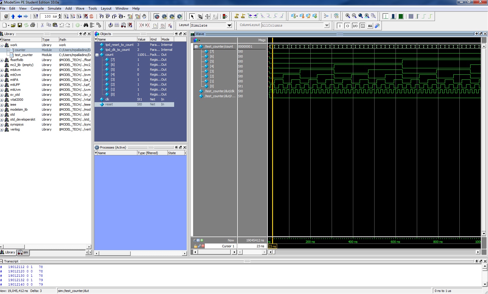

I'm trying to get some experience using Modelsim so I'm quite a noob with it. That said. When trying to run through their simple example from their tutorial I do everything they say and then when I go to run the counter I get the following error.
# Loading work.test_counter
# Loading work.counter
# ** Error: (vsim-3009) [TSCALE] - Module 'test_counter' does not have a timeunit/timeprecision specification in effect, but other modules do.
# Region: /test_counter/dut
# Error loading design
It is mentioning a timeunit/timeprecision spec but these are their files...they should be all set? Does anyone know of a good resource for Modelsim? Their website doesn't seem too helpful.
I know absolutly nothing about your program, but it sounds like you need to specify how long you want it to run (Long enough to see the whole counter count) and how big each measurement step is.
Thanks ronv. I figured it out. I saw that the provided testbench does not have a timescale so I added it in, saved it, but never re-compiled.(my bad) So when I'd go to simulate it was still simming the incorrect test bench. When I re-compile the SIM works great. Thanks for your advice. Now I can tool around with modelsim!!
