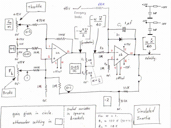

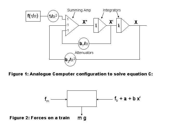

If you do the maths, as I did many years ago, a capacitor charge/discharge does not represent true inertia.
I wrote down the equations of motion of a train and designed an analogue computer to simulate them.
The basic circuit & maths are attached.
I have more info available if anyone is interested.
Note that x is the distance travelled by the train, x' is its speed & x'' the acceleration. Fm is the motor force & Fb the brake force.
a & b are friction coefficients.

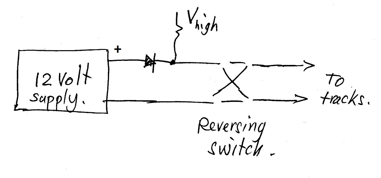

My thought on that issue was to apply a high, current limited voltage across the tracks so any brief breaks in continuity are broken down by it. The 12 Volt would be fed via a diode in order to prevent the HV being applied to the controller.
How would a diode prevent the high voltage from being applied? A diode stops reverse voltage, not forward voltage.
That is quite right. The diode blocks the HV from the power supply but not from the tracks.
See drawing.
I have not tested this idea. I don't have a Model Train.
But logic tells me that a HV must breakdown any oxide film.
The only question is how high?
I would try 50 Volt initially.

HV will break down an oxide film but you scheme does not apply high voltage to the film which occurs between the track and the train. The voltage on the track stays essentially constant whether the oxide film opens that connection or not.
Higher voltages would create more sparks, which would deteriorate the rails and wheels quicker.
