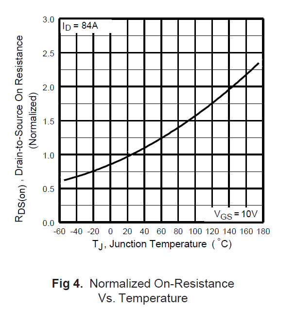

A cause of failure is that the MOSFETS aren't matched or for some reason are not at the same temperature. What happens is the hot one conducts more appreciably than the others in a parallel situation so it gets a disproportionate share and finally fails. A match might be some current, say +-10%, at a particular value of Vgs near the operating point.
I thought one of the nice things about mosfets in parallel was that Rds increased with temperature. Thus the hot one carries less current. Here is the chart for an IRF1010E:
It is , of course, important to balance the gate turn on with resistors.
