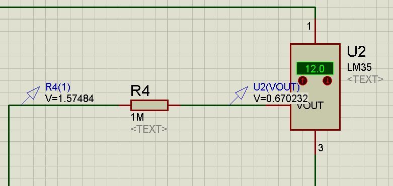

I created a new project. Displays show something but changeable. You must see on ISIS. JPEG file shows the LM35. PDF file shows circuit.

What range of full scale voltage have you set the 7107 too.?
Dont forget if, you have set it to 199.9 mV full scale and as you are using only the lowest two digits they will show 0.0 to 9.9mV so they will change randomly

For a temperature range of +2C to +50Cdeg, thats 20mV to 500mV.
What voltage display range have you set the 7107 for.???
As I said in my previous post, if its set for +199.9mV [thats the basic range] then as you are only using the least two digits on the 7107, you have a problem.
example: 10C is 100mV so you will see only '00' on the display, only temperatures less than 10C will display correctly.
I would recommend that you add another LED and set the 7107 for 1.999V, so 50C would display as 0.500, set the decimal point to 050.0
