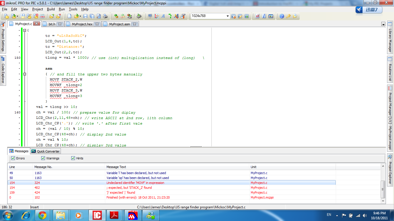

I am using PIC16F877A to build a Ultra Sonic Sensor. i fail to compile my program due to some error.
can anyone tell me the function of MOVF because i cant find any relevant info from the mikroC manual.
i have uploaded my program and the error during compile. any idea about whats going wrong?

coz i m trying to modified the program written by others and i do not know "STACK" is a register in PIC or it is a variable that created by by ourself.
do you know about it?
Actually, I used mikroC to escape asm... I believe it will be allocated on a register (GPR) but I'm not sure.

hi jameschia, use the
code
asm MOVF STACK_2,W
asm MOVWF _tlong+2
asm MOVF STACK_3,W
asm MOVWF _tlong+3
use like this...
magnatro, i tried the code already, but the error still there when i compile the program.
it stated there "undeclared identifier 'STACK_2' in expression" and "undeclared identifier 'STACK_3' in expression"
so i think it might be something wrong on the variable, not asm command.
There is no way your program knows what STACK_2 is... Its not defined anywhere.
I take it you are messing with the parameters passed in the function..ie int val !!
#define STACK_2  FSR+1
#define STACK_3  FSR+2
i have tried most of the possible code that i can modify, but the error still occur.
is there any setting that need to be done before using the "asm" function?
actually i jz to a program and it state that i need to transfer the data of "val"(unsigned int) into "tlong"(long variable).
but some bug occur during the process, so i need to fill the upper 2 byte of tlong manually.
In C we use a cast... you can't just transfer in int into a long (data mat still be in there )
Use this statement
   tlong = (long) val;   // (long) casts the val to a new variable.
This should work.
