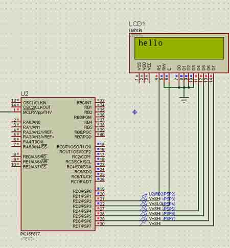

I agree with arhi as far as the delay is concerned. The Enable bit must be set for a minimum time. Also, check if the the pins of PORTB are multiplexed with analog converters or comparators.
I don't think it's the delays, since I can send out a char by just sending an ascii value to the port and I tried just passing one char to sendChar() and it didn't work leaving me to believe it's a problem with sendChar().
I still believe it might be it .. you can check the I2C lcd controller using PIC16F690 post where there is source (in csc but easily converted to mikroc) that works ok ... (compiled in mikroC, tested in ISIS)
in particular this code works:
#define D7 PORTD.F7
#define D6 PORTD.F6

attached pic is this code simulated in ISIS
as for the "end of string" .. when you make string as you did "blah blah" mikroC automatically add '\0' to the end of it so you do not need to take care of that, also sprintf and other functions do the correct cstring termination ..

I use the "send_nibble" because of the init part .. but you can do it the way you are doing it .. the thing is in the timing ...
note the _asm nop in 2 places .. for some reason - it is necessary - bit's me why :) but it helps, same thing work on 20 and on 8mhz .. so .. just one instruction delay is necessary . for whatever reason ...
also, when I remove the 2us delay for enable bit, the simulation does not run .. hence - it is necessary .. (also noted in the datasheet)
