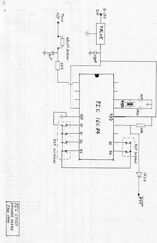

Ive been trying to compile an assembly code written for C84 to C710 but there seem to be some problems. The C710 won't startup as there is no signal on the crystal.
Can anyone help?
B.

Hi all,
Well I have a couple of these C710 in stock and I want to make people happy with it. The code is not mine and has already been posted by some guy a while a go. It is the code for a CTCSS tone generator. I've just changed 16C84 into 16C710 and compiled with MPASM for the correct uC.
Checked all the I/O's and Eprom memory of the C710 and in my oppinion this could not give any problem.

or is it just about bit 0 and 1 from this register PCFG0 and PCFG1 to set for RA2 and MCLR on pin 1 and 4. RA3 and RA4 are not used. How do you add this in asm?
Where, after line 11 somewhere or first to begin with? These C710's are hard to re-progam haahah, ruined a few already. How many chance for working instantly?

Hope it will work, the un-modified software did not startup the oscillator on the C710. Will compile tomorrow at work and test later in the afternoon, will let you know, thanks!
And I've read that some programmers/experimenters have troubles with programming XT for 4 MHz and do HS for that, could that be the probblem? Is the output on pin 1 digital or just analog? See schematic attached.
